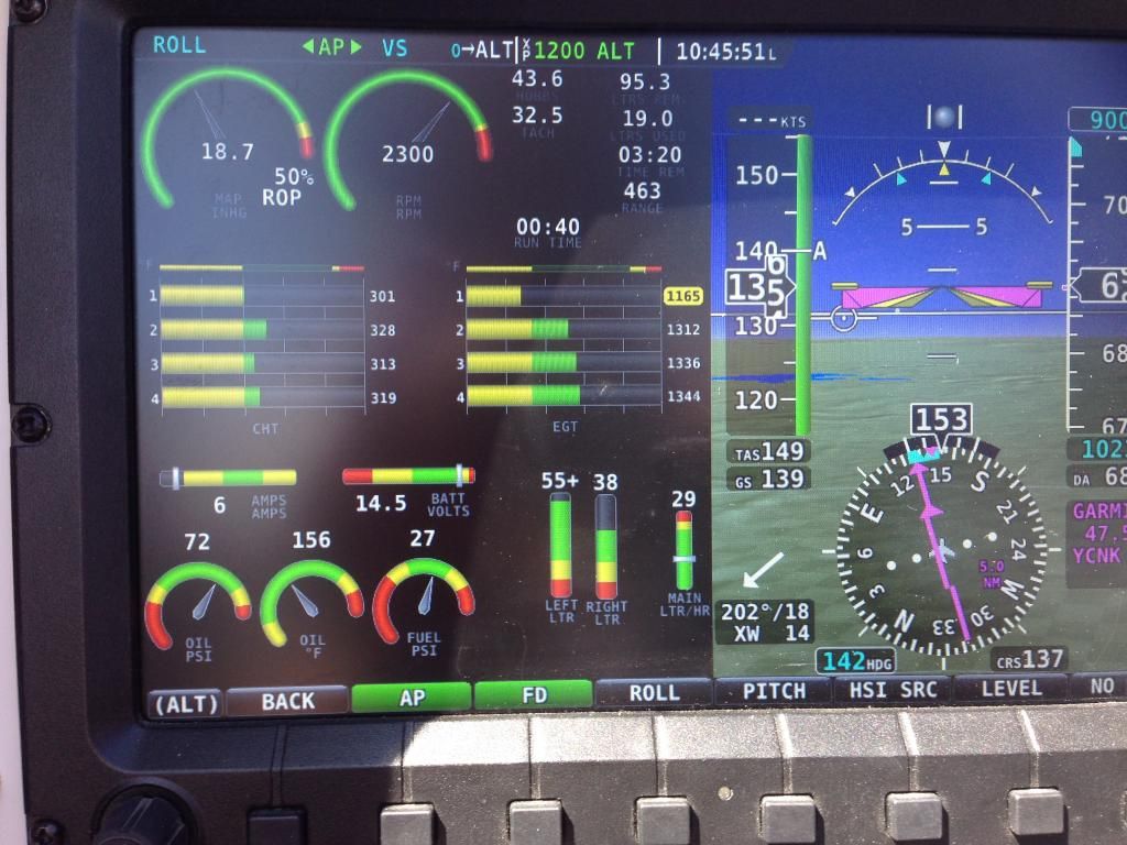

Default Apologies - AP newbie question
My AP has been working perfectly in Simplified Mode since new. It held altitude, climbed and descended to target altitudes perfectly and controlled, it did everything I hoped for.
I updated to 10.2 and now it won?t do any of the above, won?t hold altitude it fly?s like a porpoise, and descends erratically ie it wont descend at a constant rate. In Roll the AP is ok, Pitch is next to useless.
To fix this new problem, Dynon has suggested I refer to the Autopilot In-Flight Tuning Guide, see extract below.
In particular, if the autopilot cannot keep up with the flight director pitch command bar, PITCH SENSITIVITY should be increased. At some point the AP will track the command bars, but follow behind them.
My question is where or what are the "Command Bars" ?

Old 09-21-2014, 03:04 PM
Join Date: Dec 2011
Location: Livermore, CA
Posts: 6,766
You need to change the main efis display to "flight director" presentation. Then you will see two inverted 'V' s replacing the dot and bars of the conventional display. The Vs represent the wings, the vertex is the nose. One of the Vs will move with the airplane, just like the AI; the other V is the "command bar", and shows where the box thinks the plane should be. When hand flying you nest the Vs together. The autopilot should do the same.

Old 09-21-2014, 04:20 PM
Derek Derek is offline
Join Date: Jan 2011
Location: Sydney, Australia
Posts: 86
Default Thanks Bob.
Here is a photo of what I'm seeing. Im guessing Ive got the V's nested ?

Old 09-24-2014, 09:00 AM
dynonsupport's Avatar
dynonsupport dynonsupport is offline
Join Date: Jun 2005
Location: Woodinville, WA
Posts: 1,499
Derek,
Yes, those are the 'airplane' and command bars nested together.
As you turn up PITCH SENSITIVITY (and later PITCH GAIN if you need it) be sure to turn it the minimum necessary to achieve the performance you're after. As you get close to the right setting, the improvement becomes softer as you increase gains, and it's possible to over do it.
