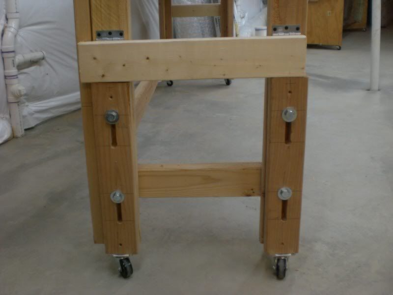

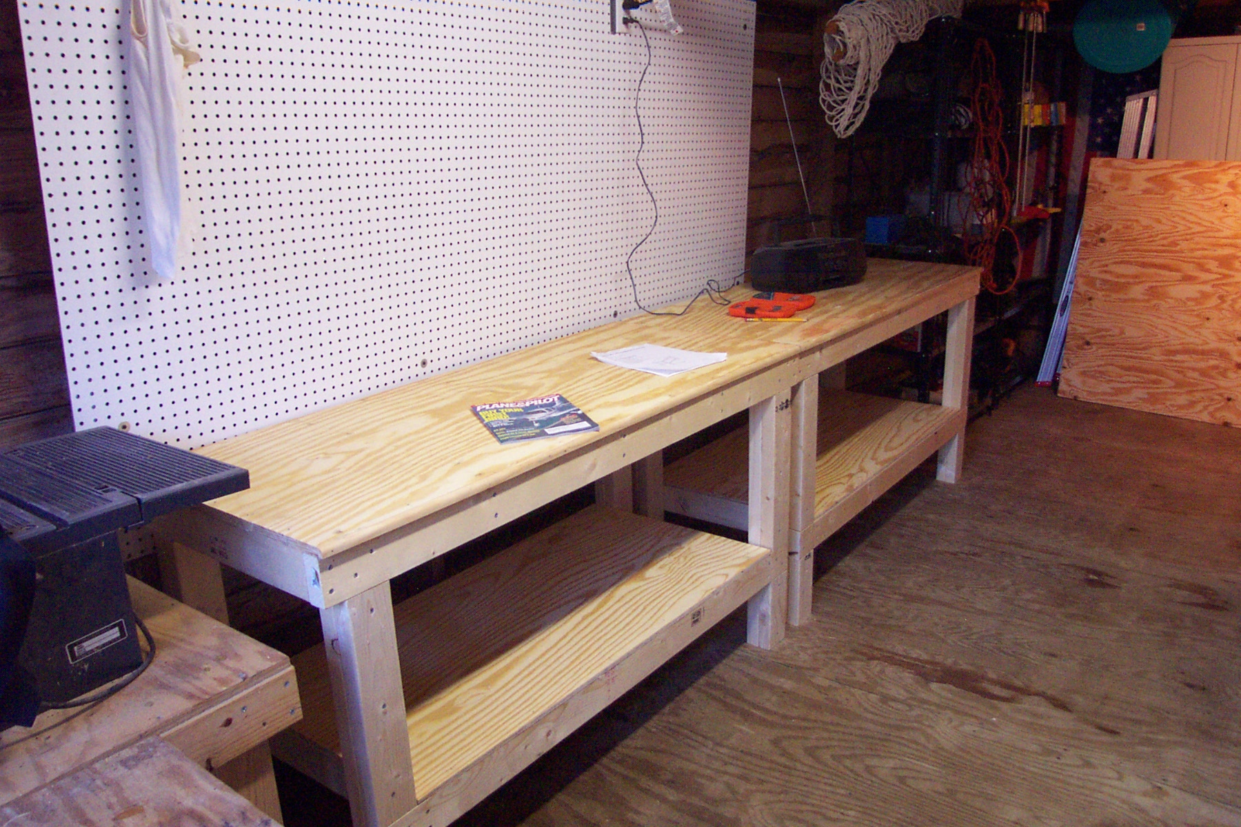

Default Here is what I built
Martin,
I built 2 benches like this. They are able to be moved easily and can be nice and solid if you retract the wheels.
[IMG][/IMG]
[IMG][/IMG]
[IMG][/IMG]
Bob "Skyking" Corriveau
RV-8 QB Reserved N212KB
ATP
CFI/CFII/MEI
