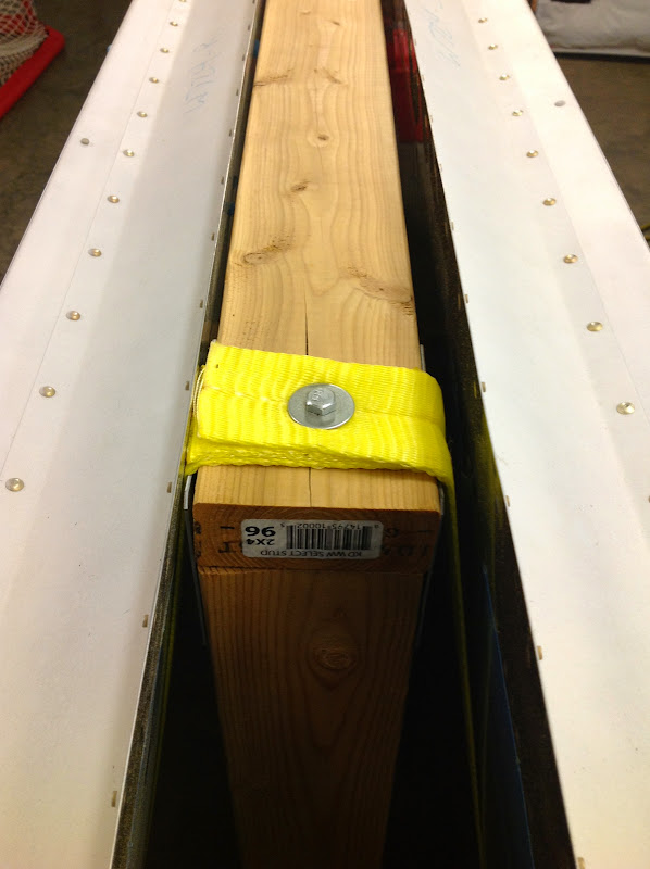

+1 for the wing stand. Here are some "after" shots. I dont have wood working tools or skills, so I just used the Home Depot brackets that allow for 90deg joints to be made. Deck screws and lag bolts hold it all together. The straps I found in Lowes/Home Depot are just towing straps. Pick good wheels I had cheap ones at first and they disintegrated after about a year.

You can use strips of carpet instead of straps, that will spread the load over a greater area. A lot of builders have built racks like the one pictured. Easy and cheap to build, does a great job.

This design seems fairly common in the RV world. The padding is foam pipe insulation.
