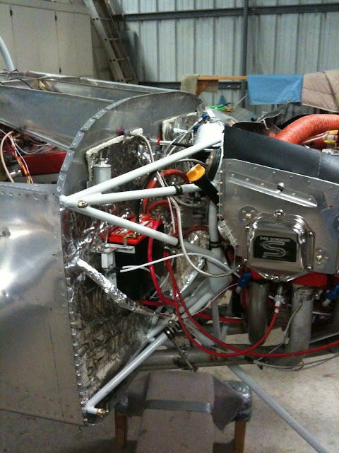

This is a picture that was originally posted on post #4 in this thread:
http://www.vansairforce.com/communit...ad.php?t=97778
The picture no longer shows up on that thread though.
Here is a link to the material I used:
http://www.aircraftspruce.com/catalo...rewall2000.php
That material is discussed in some detail on this thread in posts #55-#59. This particular thread has quite a bit of detailed information from Dan Horton's testing. It is a good one:
http://www.vansairforce.com/communit...t=47587&page=6
Do a search on firewall insulation and you will find a great deal more info. To get you started, in addition to the threads mentioned above, here are a couple of more threads discussing firewall insulation that you might find interesting:
http://www.vansairforce.com/communit...hlight=RVbySDIpost #9

This is Nomex felt, just before ignition of the main body.
If the firewall gets beyond 1200 deg (well below the Nomex and insulation critical temps), I will have big issues keeping the plane in one piece. The firewall and engine may (unlikely) depart the plane.
The anecdotal and documented fires all show the same pattern. Fire follows airflow; the hot spots are the lower firewall, and the floor aft of the cowl exit. I'm not aware of any single engine GA fire involving engine separation, so yes, it appears unlikely.
In any case, installing a stainless foil/ceramic insulation combination on the hot side protects the structure. I'll bet you don't wear your raincoat inside your clothing.
My reluctance to going this way is the everyday maintaince, where a clean firewall surface makes life easier. I worry about the insulation soaking up oil and becoming ineffective. Anyone else have this concern?
Stainless foil has held up well. It looks like this after three years of maintenance and experiments, and I've made no special effort to be gentle. The insulation can't soak up anything, as the perimeter is sealed with 3M Fire Barrier 2000 intumescent silicone.
