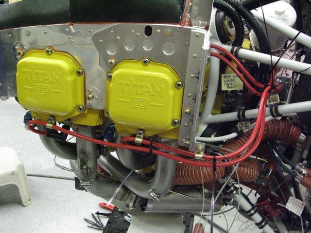

I can't seem to locate any pictures of how others have routed their spark plug wires from the mags to the plugs and the diagram that came with my engine isn't a lot of help. Does anyone have pictures of the left and right sides of their engine as well as pictures showing how the upper plugs route from the mags to their respective sides?

Not mags but you can search/browse my build log for some pics of how I did it.

Hope these help...
Added one more adel to support wire below...

The shortest wires go to the bottom plugs.
Right mag fires bottom plugs on right side, top plugs on left side.
Left mag fires bottom plugs on left side, top plugs on right side.
Is that what you meant?

I followed the wiring diagrams in the Lycoming manuals for spark plugs.
Google "lycoming spark plug wiring diagrams" and you should find a decent picture to follow.
Here are some pictures from my installation.
