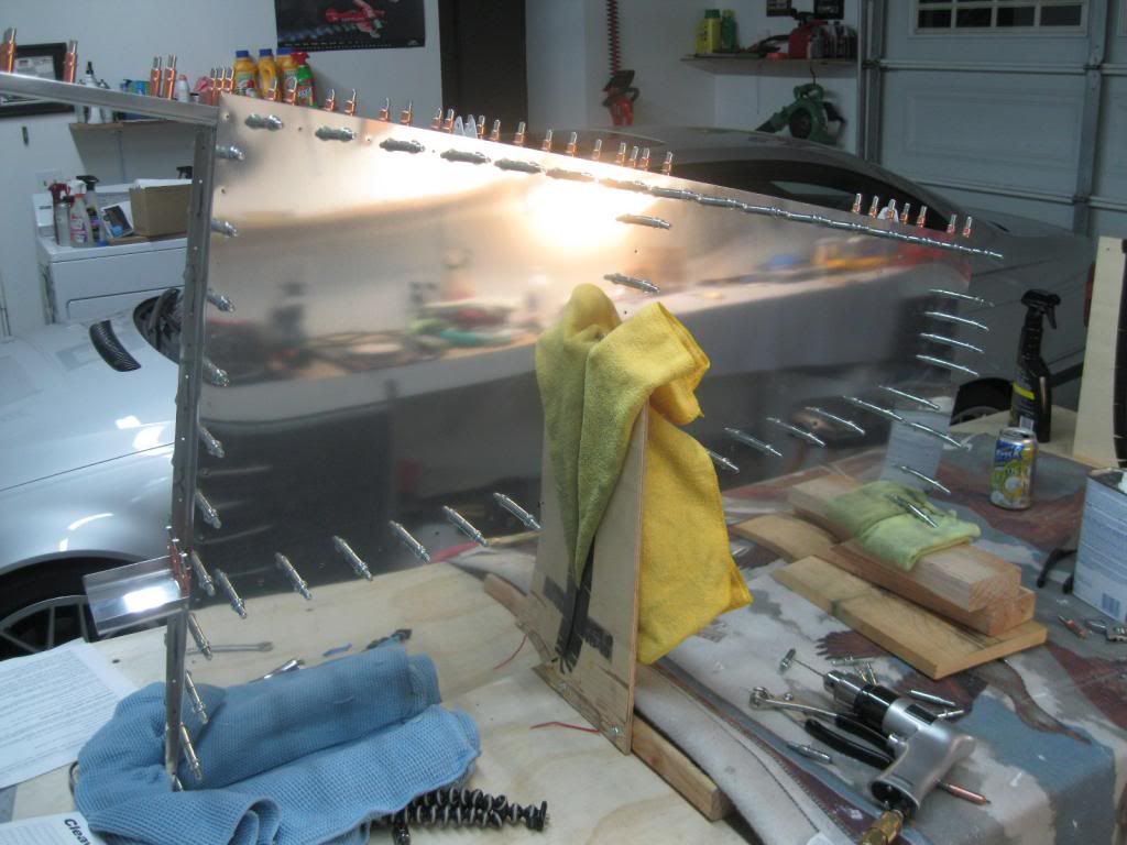

Everything is going so much faster now that the workbench, dimpling table, etc. are built and I'm up to about 30 cpm (clecoes per minute ). Got the rest of the VS parts deburred, skeleton assembled, skin on and match-drilled the whole shebang.
Quick question: the gauge of the front VS spar is a little thin…did you guys use dimple dies here, or machine countersinking? It seems to be that in-between thickness.

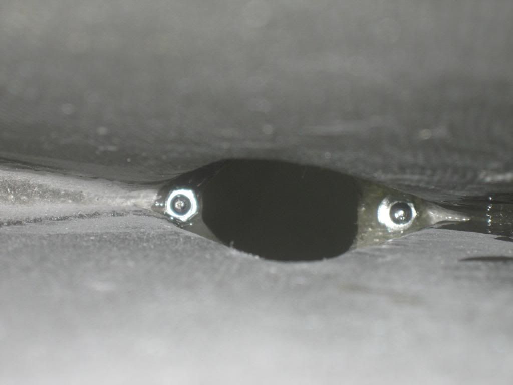

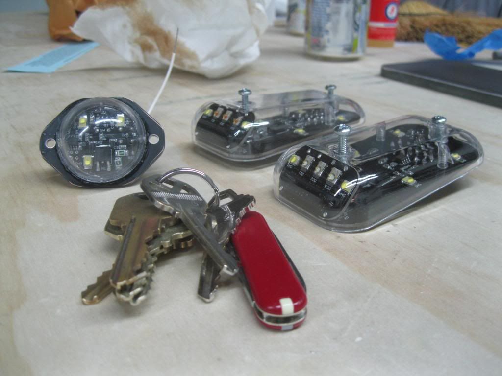

My strobes from Ztron Labs came in, so I finished up the stiffeners for the rudder and switched gears to mounting the tail strobe. I cut down some blind nuts and epoxied 'em in place…hardest part was getting them into position in the tight confines.
The wingtip strobes are really low profile, so I'll have plenty of width in the wingtip cutout for a landing light. I want to avoid cutting into the wings' leading edges if possible.

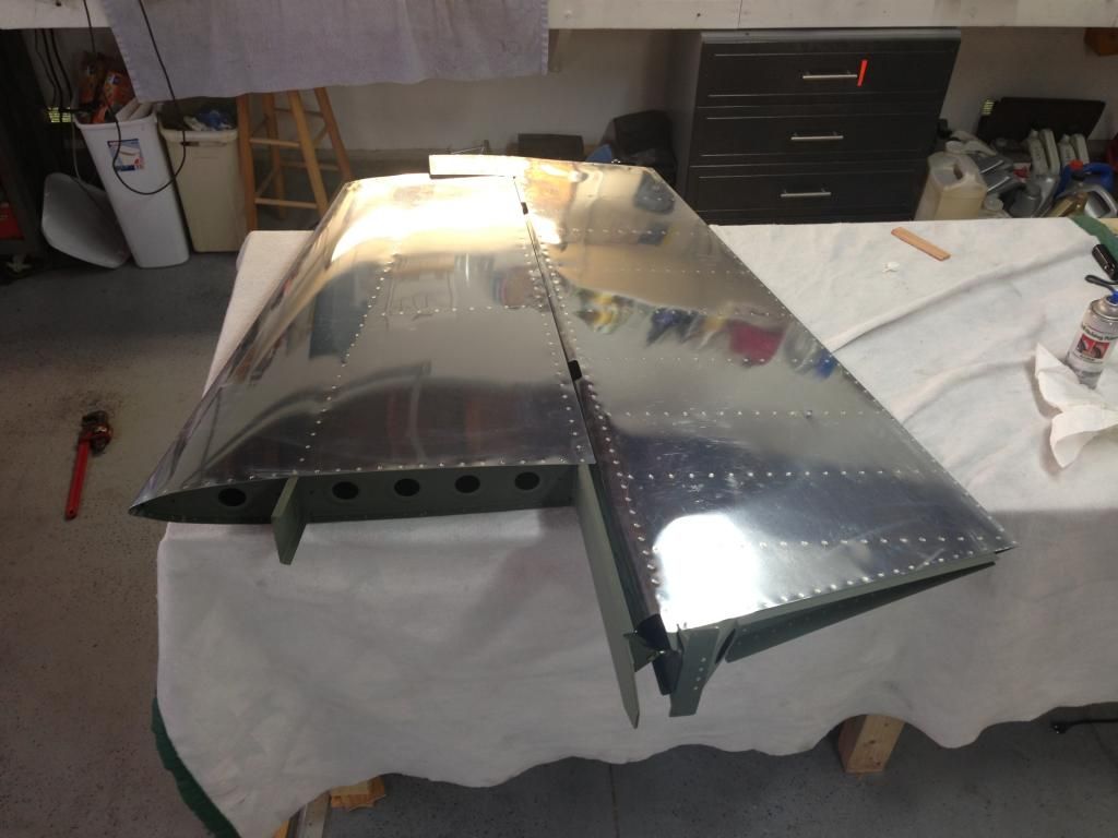

Some more progress. Very exciting to hang the finished rudder on the vertical stab! The trailing edge turned out nice and straight, and I didn't have to drill out a single rivet. I had a lot of apprehension about this step, but I re-read instructions about 14 times and followed them to the letter, and it worked perfectly.
Rolling the leading edges wasn't too difficult, but it was a bear to bring the rolled surfaces together to cleco & rivet. Took a lot of grip strength and yards of Gorilla tape.
