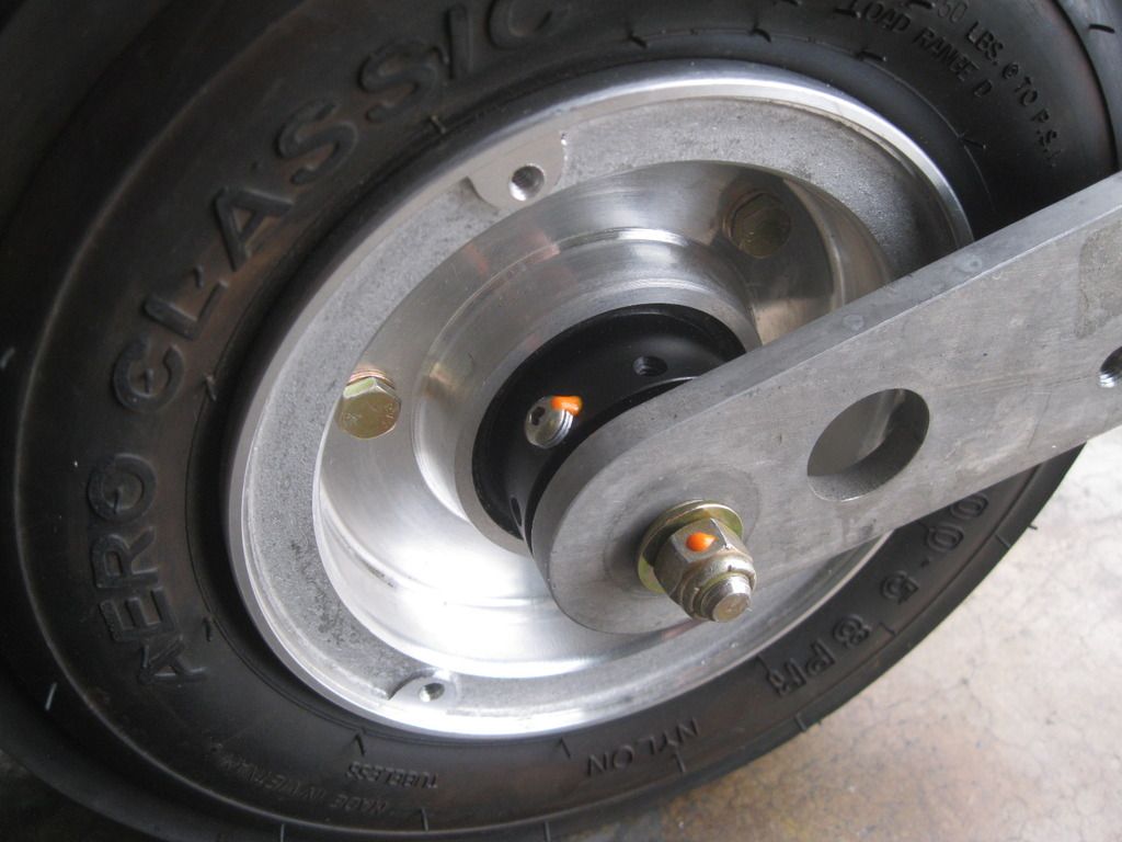

The day before, I installed a Matco axle for the nose wheel, which allows you to preset the load on the tapered roller bearings rather than having the axle through bolt perform the same function. The wheel does seem to roll a little easier when properly set up, and the leftover Van's bearing spacers make great paperweights!
