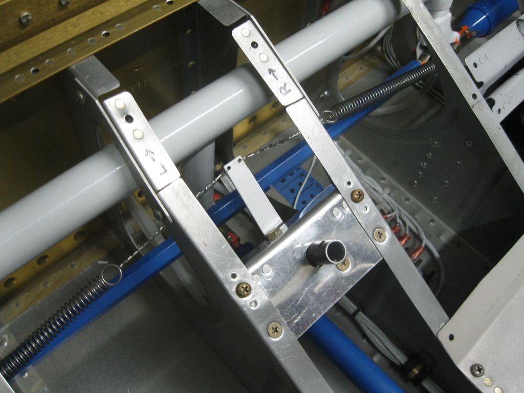

Finished up the aileron trim mechanism, safety-wired the tank attach brackets, hooked up the strobes/landing light for a post-Christmas green/red light show, and generally neatened up the wiring around the control sticks. All control surfaces rigged, and jam nuts tightened, Loctited and marked with TorqueSeal.

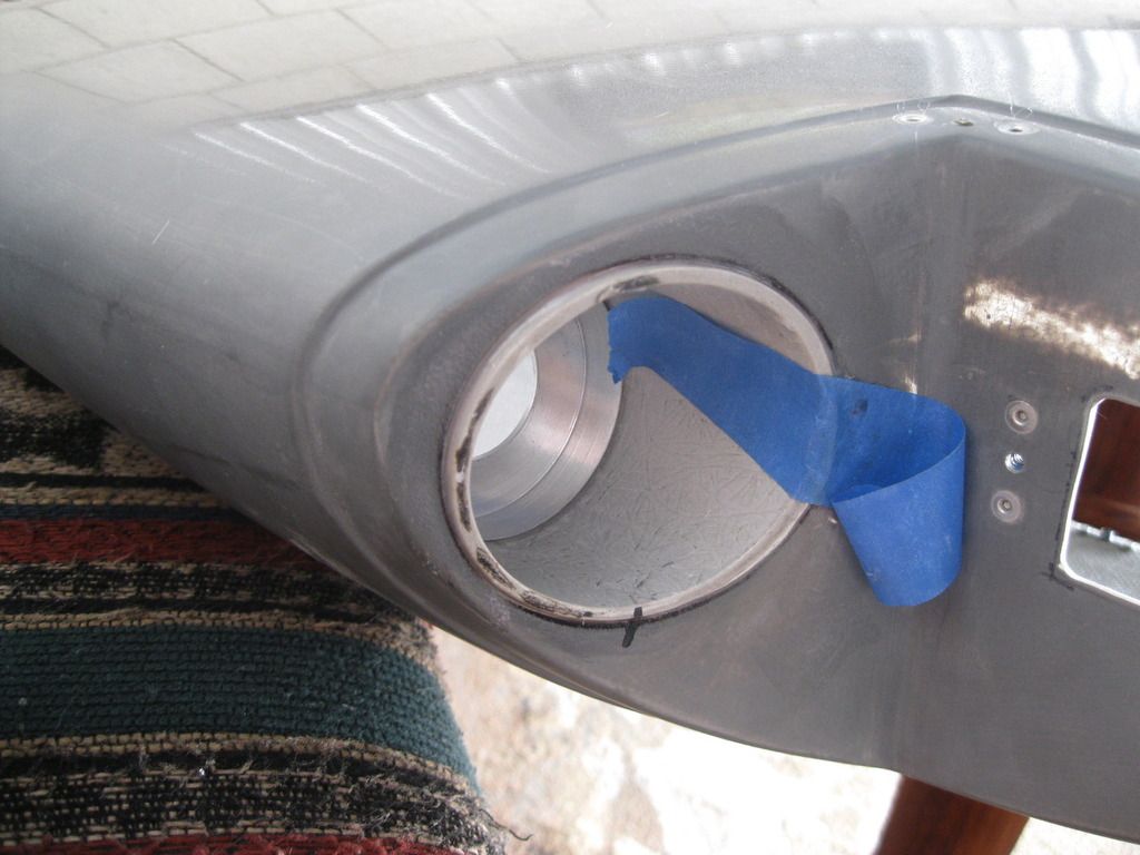

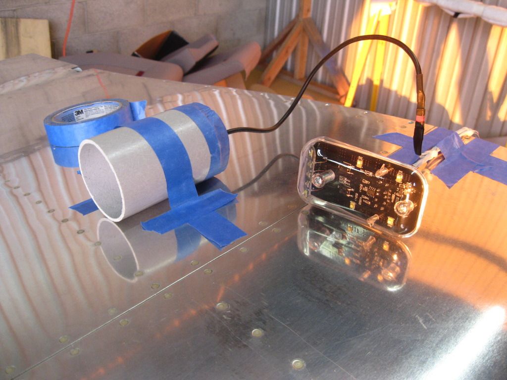

Couldn't sleep, so I was on the road at 5:30 a.m. to the hangar and made it back by lunch. I was able to finish off a lot of little details before The Inspection.
First up, DuckWorks landing light. They supply the fiberglass tube, and the toughest part here is aiming it. Luckily my hangar faces an open dirt lot, so I elevated the nose wheel by a few inches (to simulate flare) and set a cardboard box about 75 feet in front of the plane. The I hogged out the wingtip hole bit but bit until I could angle the beam down and inward enough to illuminate the "runway." Then it was just a matter of flox, sand with mini pneumatic die grinder, a little dry micro, and we're off to the races.

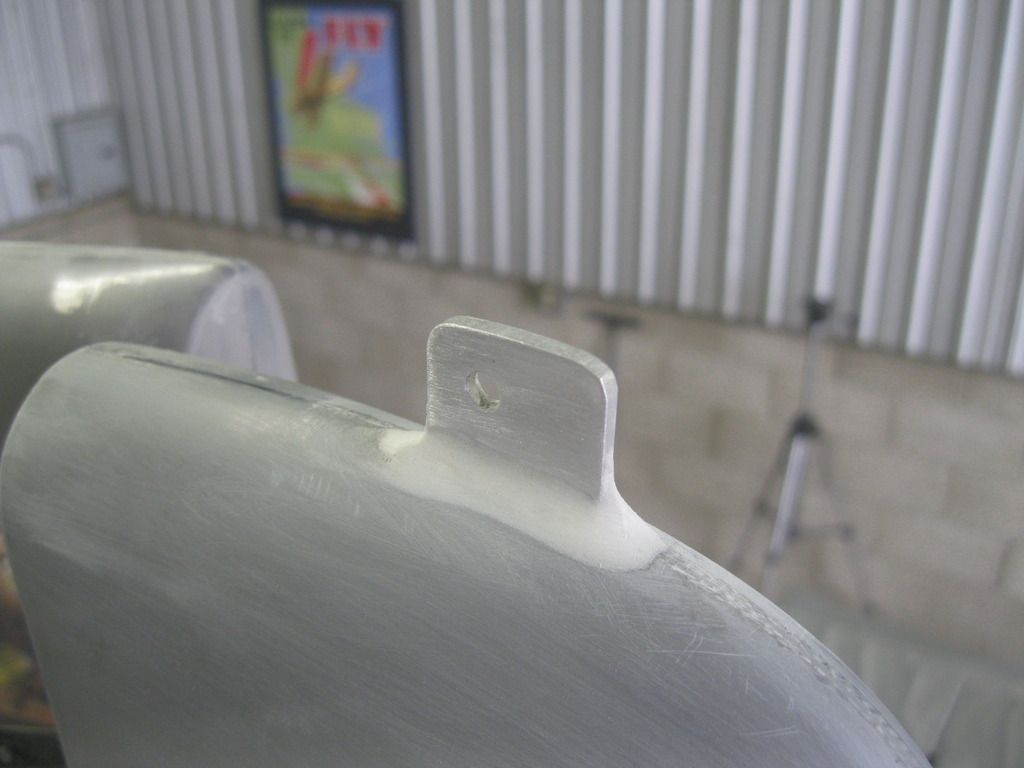

Next, a super-easy GoPro mount for the top of the vertical stab. Cut a short piece of 1/8" bar stock, Dremel a slot in the top of the fiberglass fairing, flox & dry micro; sand to taste.
It's super sturdy, and if I ever want to remove it, I'll just cut it off and grind it flush. The nice thing is that the 1/8" stock fits perfectly in the slot of the GoPro case, and the hole is perfectly sized for an AN3 bolt.

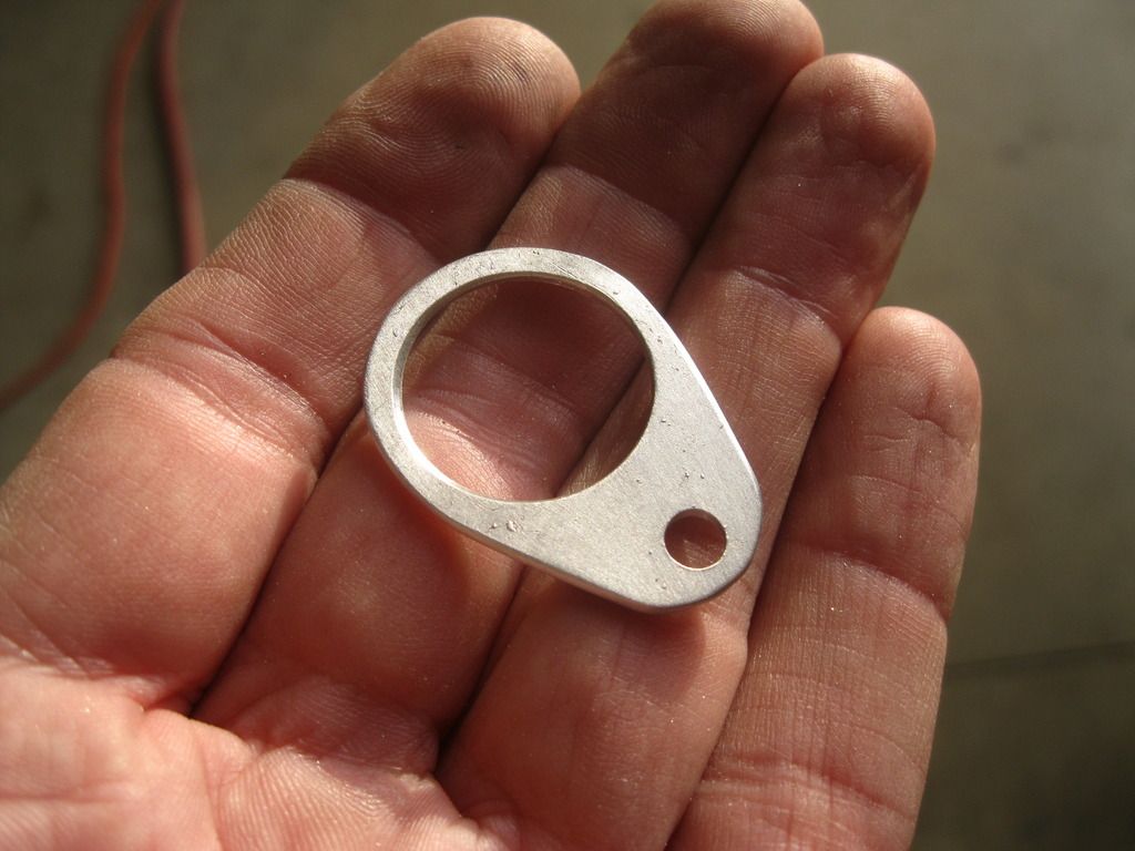

Last, I made this little pull ring out of .063 stock. When I refitted the canopy, the right side was hanging up a little on the fiberglass fairing when closing. If I pulled in only about 1/16", it closed nicely, but there was no real easy place to grab it from the inside, hence the ring. After it was installed, I beveled the edge of the plexi a little more, which seemed to solve the problem, but it's nice to have the pull ring if the problem ever surfaces again due to heat expansion, etc.

Thanks Mike! Another nice thing is that the top of the aluminum is shaped so that the case can only rock back a couple of degrees, so if the bolt loosens or the blast from the air proves too much, you still have usable video.
Nice idea.
Just one comment - I've been doing similar things with Hero 2 housings on my Pitts for a few years. So far I've found 3 cracked housings (and lost one camera). What can happen is that a small crack appears in the 2 flanges on the bottom of the case. I'm beginning to suspect that this is because either the AN3 bolt is too tight or because the single central metal flange is either too thin or lacks the surface area to provide enough friction to resist 200 mph winds. Now I'm aware of the problem I've managed to spot the cracks before the camera departed - the cases are relatively cheap and easily changed. I'm sure your bracket will work fine - just suggest you don't over tighten and check for cracks in preflight

Doug, brilliant idea with the camera mount.
Methinks it is likely to be "stolen" by more than one builder in the future.
I guess I'm one of the thief's! If you don't mind, I'd like to steal your idea. I also read following post about the cracking of the housing. Perhaps a thin piece of phenolic might work?

Y'all may already know this, but the vertical stab is subjected to a lot of vibration on start up and shutdown.
