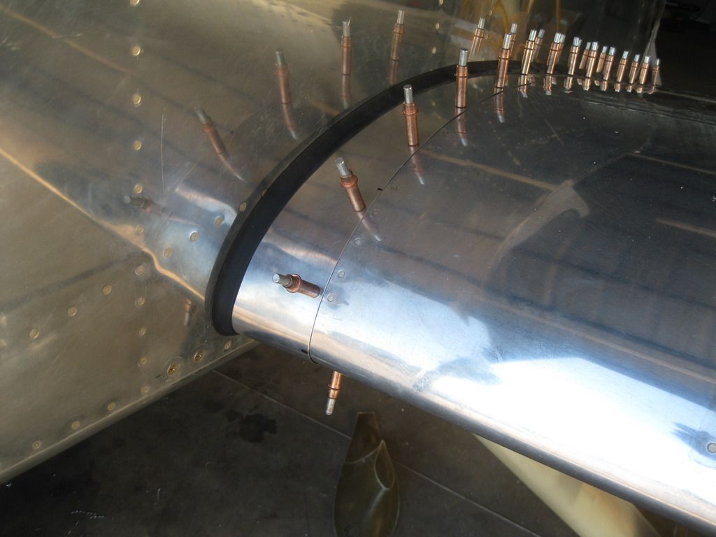

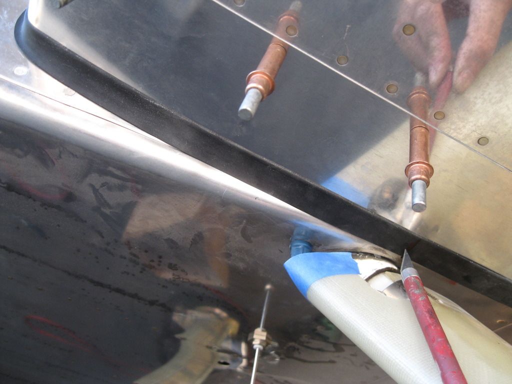

I'm pretty much ready to pull the wings back off for a final furious nut plate and countersink session. The root gap fairirings are on, and with a 3/16" clearance trim, the seal fits nicely with the proper fillet curve up against the fuselage.
The only issue was that the bottom pilot hole for the tank screw was too far forward by about 1/8". Of course, I had already dimpled this hole before I realized the error (), but no worries....flatten the dimple with a hammer, oval the hole back with a Dremel, re-dimple. It's not a structural concern, and the intersection fairing covers it up anyway.
I cut the seal on the underside about even with the gear leg. Any longer, and it goes beneath the level of the fuselage and isn't held in place.
No pics of the intersection fairings, but I went with the Fairings Etc. pieces, and they are a great fit and required minimal trimming. Highly recommended.

Don't cut the underside rubber gap seal until you get the upper intersection fairings on and fitted. You'll end up shortening it a bit. You'll need to put a dab of contact cement or pliobond on the end of the seal to keep it in place.
Bruce Hill
2020 VAF donator
  #235
Old 11-20-2015, 07:30 PM
Join Date: Mar 2014
Location: Laguna Hills, CA
Posts: 1,805
Hey Bruce,
Does the end of the seal butt up against the leading edge of the intersection fairing, or go beneath it? I've drilled mounting holes for the fiberglass with the root gap fairing in place, but without the seal. It seems that the intersection fairing will go nicely over the rubber channel.
If it doesn't, a simple matter to cut it later.

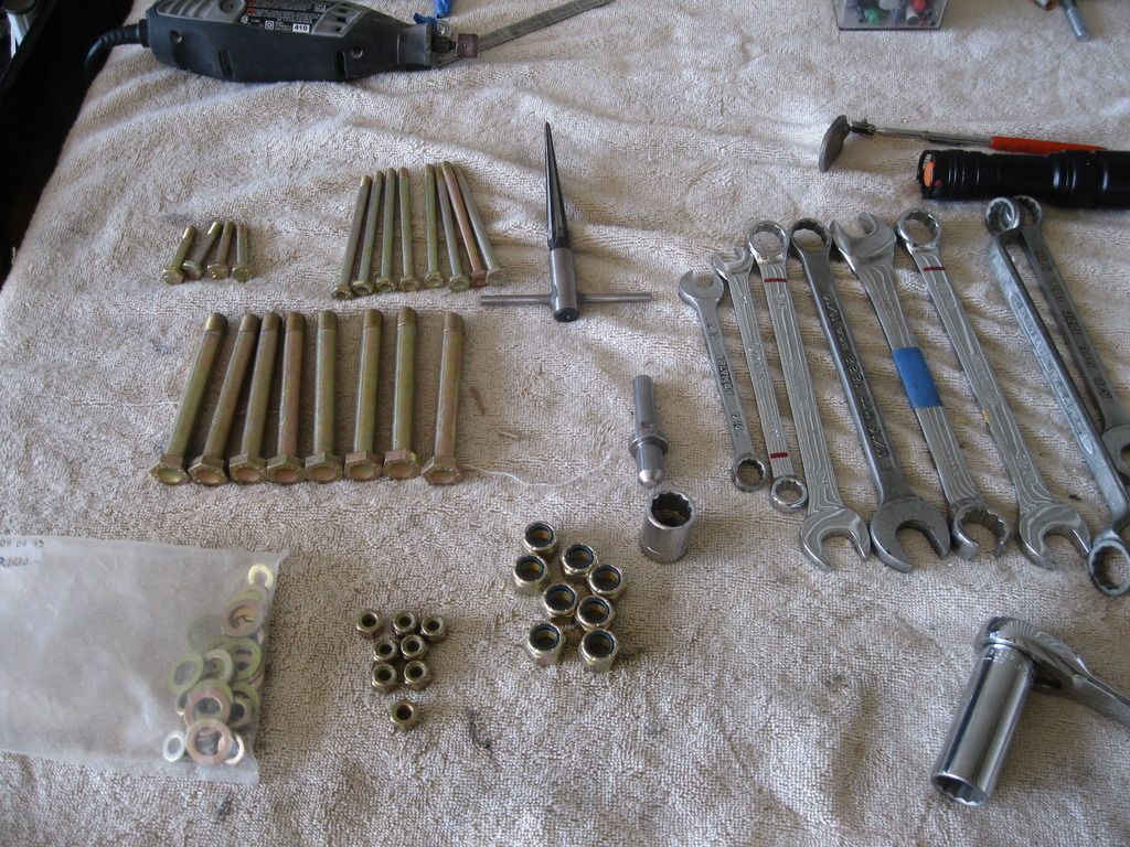

Old 12-13-2015, 03:35 PM
Join Date: Mar 2014
Posts: 1,805
Finally, got to drive those close-tolerance wing bolts home. There were a couple that I had to tap a wee bit harder than I'd like, but the way i figure, better too tight than too loose here. I highly recommend unthreading the pushrod and pushing it outboard far enough so you have clear access to all the bolts. As such, I was able to get a free swing at all bolts with a hammer and didn't need to use the rivet gun method.
So at the end of a full work day tomorrow, I hope to have the empty weight numbers. That may be too ambitious, as I'm not sure how long it'll take to get the bottom nuts on those bolts and torque 'em.
