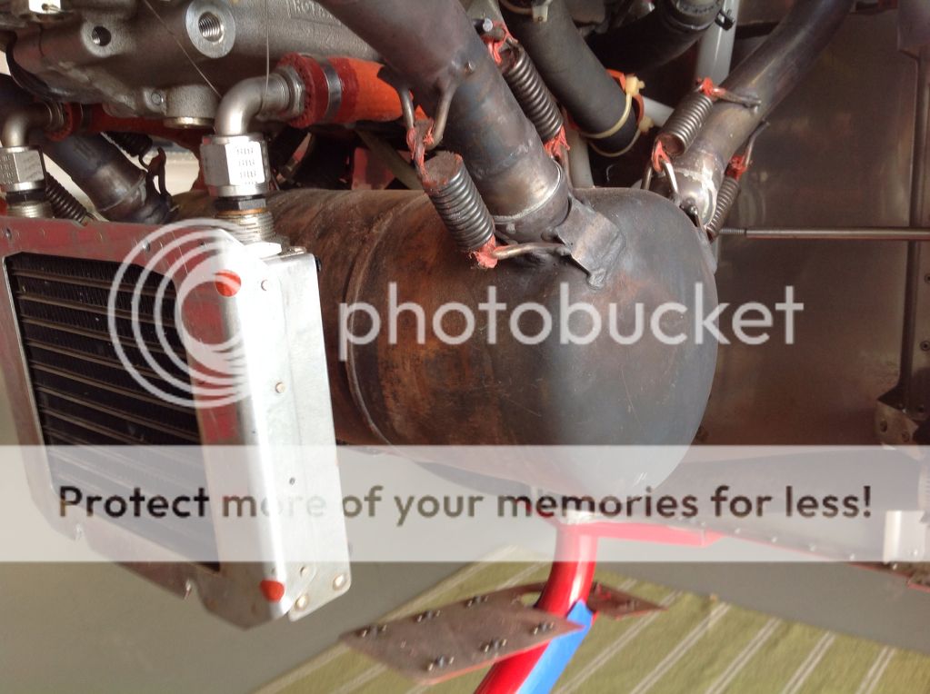

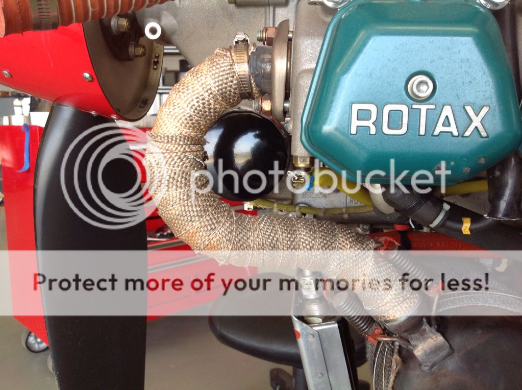

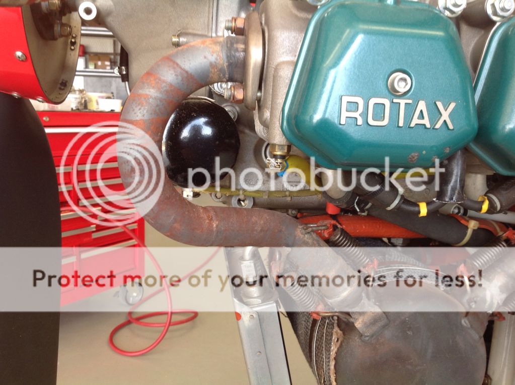

I had hot oil temps during the summer months. I tried header wrap on the to front headers and the muffler drum. I don't think it helped my high oil temp problem. My header wrap has been on for about a year. This winter I modified my cowl and moved my oil cooler forward 1 inch. I think this has helped but won't know until this summer around July when I will know for sure. Today I removed the header wrap and as you can see in the below pics that the wrap as stated by vetterman is has cause it to start rusting. With header wrap on you exhaust you can expect to cut the life of your exhaust in half. A few facts on my setup.
Live in a dry climate.
Have flown in light rain on occasion.
Did not install header tape wet.
Tape was on 1 year and about 100 hours.
First pic wrap installed.
This pic after header wrap removed.
Pic of muffler after wrap removed.
So in the end you can see that the wrap promotes rust. Which would shorten the life of your exhaust system, by how much I don't know. Humid climates maybe worse in this respect. You make the call.

I have been hearing about high temps, and JetGuy just said it was oil temps. From his pictures it appears the large, hot surface area of that muffler is in full view to the backside of the oil cooler. The cooler would get a huge radiant energy input due to the view factor. If oil cooling is the issue, as anyone put a simple heat shield over the full face of the muffler? It can be thin aluminum and with a small gap (3/16-1/4")to the muffler. If it works, then stainless may be better in the long run.
Is oil temperature the issue and has the shield been tried?

A heat shield has been tried by different people within the RV12 community with varied results. Some builders have reported less than 3/4 of an inch between the rear of the oil cooler and the drum muffler. Durning the summer months depending on your location in the USA. OAT could reach over 100F. That muffler in these conditions would be over 1200F. Oil temps could reach over 250F durning long climbs to cool air at altitude.
266F is the red line.
232F to 265F is the yellow arc.
121F to 231F is the green arc.
(+-2 degree error)
You can operate in the yellow arc as much as you feel comfortable,
You make the call

Regarding the wrap, Larry Baker tried it in an effort to reduce oil temps prior to moving the oil cooler. IT did not help at all, in fact, due to the wrapping of the springs, he wound up with a massive exhaust leak in flight.

Wrapping or a shield feeds a vicious circle. Either reduces the space behind the cooler for the air to exit having come through the cooler. That offsets the benefit of the wrap or shield. Moving the cooler forward and increasing the gap between it and the muffler seems the best solution.
