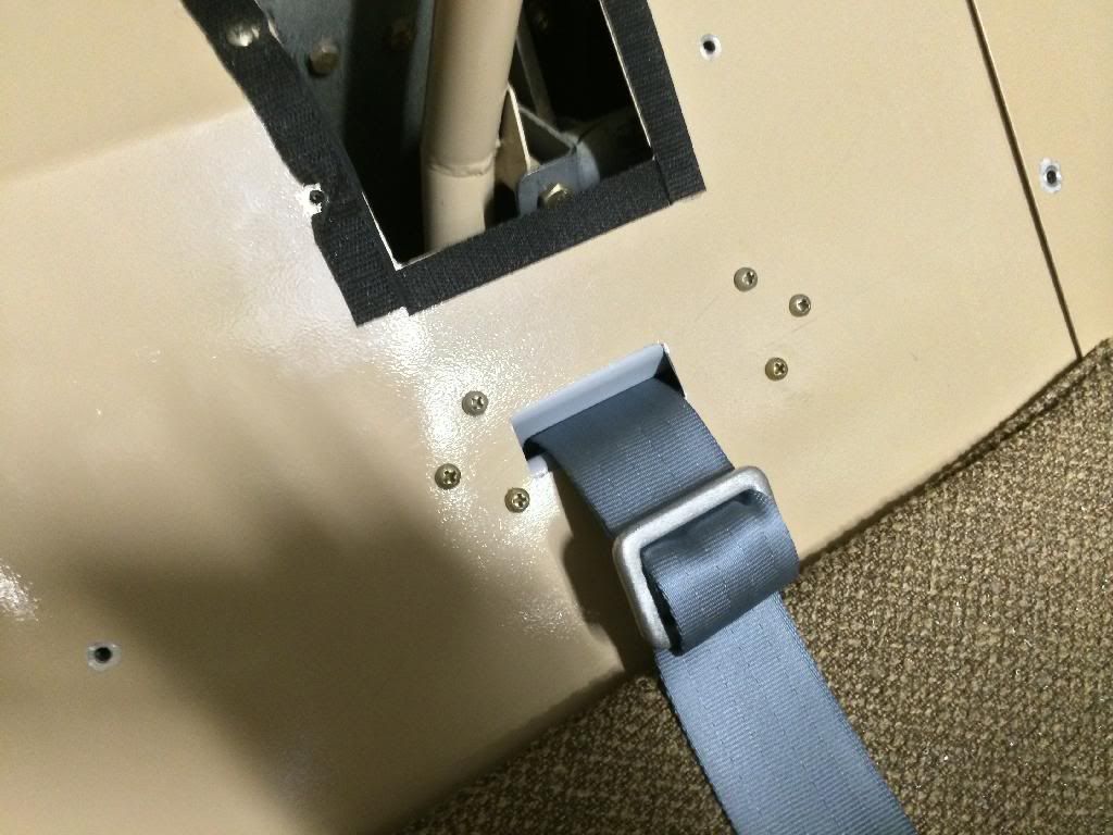

I currently have Oregon Aero foam w/ no cutouts. However, the crotch strap runs in front of the seat w/ very little deflection and holds everything fine. I have Classic Aero seats on order that do have the strap cutout.
The location of the seat pan nut plates really determines where the cutout will be. One of the shots will show how I cut down the strap mounts and riveted on new angle to narrow the mount between the ribs.
And yes, the 5-point buckle 'tang' is longer to accommodate the extra strap.
