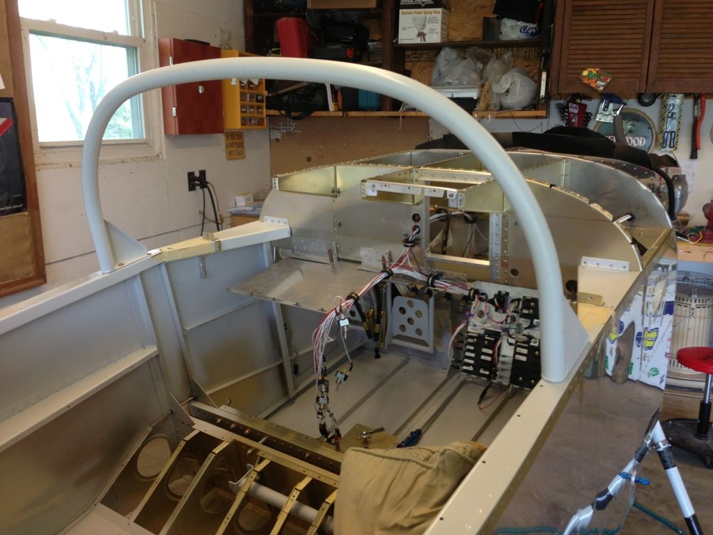

You asked about fuse locations. You cannot see it in this pic but I mounted a hinged panel underneath the panel on the passenger side. It is hinged on the sub panel and secured with Velcro to the bottom of the panel just under the passenger side EFIS. That panel holds the fuses. All I have to do is pull the panel free from the Velcro and I have access to the fuses.
Another thing that is not showing in the pic above is the mounting of my iPad. I used a RAM mount on the passenger side bracket where the windscreen frame attaches to the fuselage. The pic below is not very good quality but it shows this iPad location.

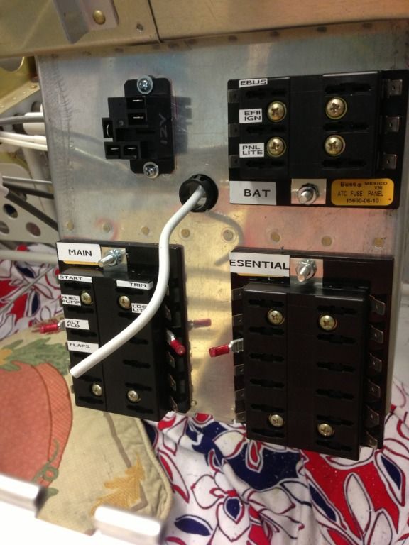

Here's a pic of my hinged fuse panel, probably would make it fixed next time. A lot of extra work went into making it hinge without pulling the wires, and provides marginal access. I used hinges on the panel and subpanel to attatch it, pulling the front hinge pin releases it to swing down.

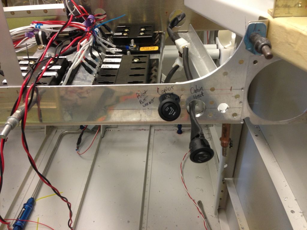

Just one quick note, when my wife is getting cold, she tends to grab stuff and pull! I would move the alt air to the other side of the engine controls away from the cabin heat. Infact, I would move the cabin heat up to the panel away from anything else!

if you look at my first pic in post #12 you can see I placed the cabin heat lever all the way to the right just under the passenger air vent. There is nothing else over there that a cold passenger might accidentally grab. This placement is one of the things I thought about during those many many many times of sitting in the cockpit thinking about where things should go.
