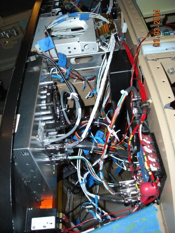

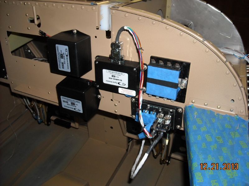

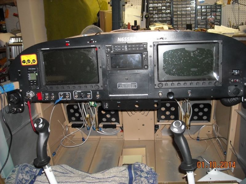

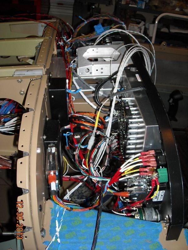

In my 7 tipup, I mounted one 10" screen on each side of the panel with a GTN-650 and PMA5000 in the middle.
I left the panel support ribs out because the radio stack and glove box are screwed to the subpanel and basically replaces the function of the ribs. The glass panels have a much smaller moment arm on the main panel than steam gauges so I assumed the setup would be strong enough. I asked Vans and they said a lot of people do that, but have no comment on the impact of leaving the ribs out.
The ELT, xpnder and ADS-B are behind the baggage bulkhead with the antennas just below. Only a 12" coax from unit to antenna.
Archer Nav antenna is in the wingtip.
The EMS, ARINC, Dynon Comm radio, 2 backup batteries, battery buss, and network hub are all mounted on the sub panel. I have full access to all the boxes with the canopy up.
Only the VPX box is under the front skin. I did not want to have to lay on the floor to access any of the electronics.
The pics below were taken when work was in progress. The wiring was cleaned up and laced and the system checkout is complete.
Bob B
