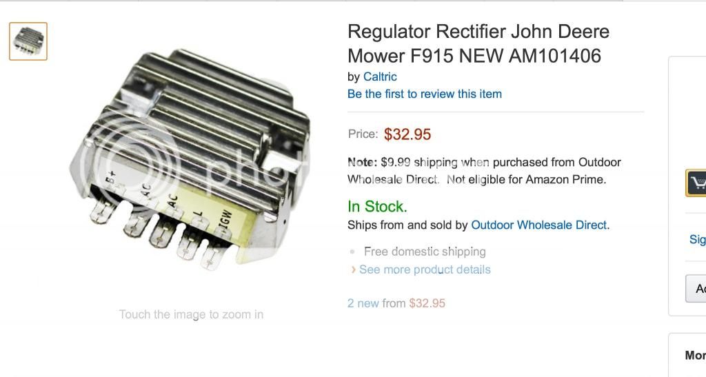

I am wondering if anyone has a cheaper alternative voltage regulator for the Rotax?

John Deere part number AM101406 will work, although the spacing and arrangement of the contacts is different and will have to be changed. It can be purchased at a John Deere dealer, or on eBay for as little as $45. The ones on eBay are not all equal and could be manufactured by various companies. Regulators should be kept cool. Heat is the enemy of electronics.

Joe would this be the correct one?
Here is the Amazon link.
http://www.amazon.com/Regulator-Rect...HA363BQMWRXMW2
Joe give us the wiring setup.

John,
Yes, that one should work. Keep in mind that it will NOT be plug and play. The mounting screw slots might not line up. And the electrical connector will not plug in. The female sta-kon terminals will have to be removed from the plastic housing which can not be used because the spacing is different. The large yellow wires from the dynamo will connect to the AC terminals. The large white wire from the instrument panel will connect to the B+ terminal. The small wire from the master switch will connect to the IGW (IGN) terminal. Terminal L (Lamp) is not used. Heat conductive grease applied to the mounting base will help to transfer heat away from the regulator.
