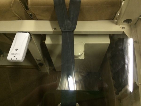

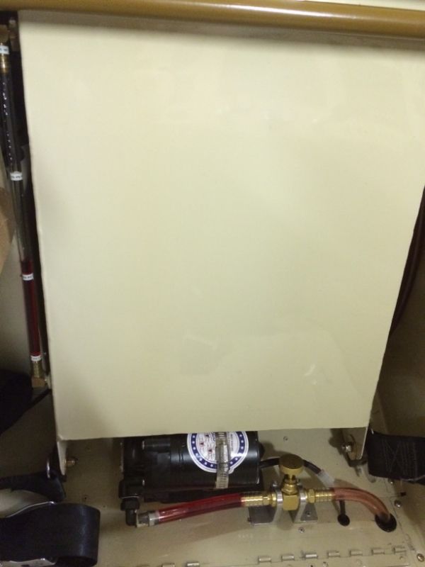

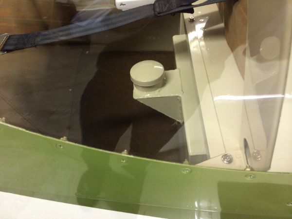

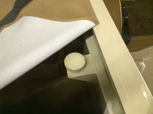

I also am a fan of Marvin's system. I thought I would post a few pictures showing the finished product and how well it blends in.
[IMG][/IMG]
[IMG][/IMG]
[IMG][/IMG]
[IMG][/IMG]

Good installation John, I thought about mounting the valve where you did but I could not reach it.
Marvin is great to work with, we had a few discussions since his recommendation is to mount the nozzle's on the No 1 and 2 cylinders exhaust pipes but I have a 4 pipe system and it worked great on the back two cylinders. . Most planes that have smoke have a 4 into two exhaust or 4 into one. It is amazing how little you have to open up the valve to get smoke.

Jack, You are right that I can't reach the valve if I have a passenger. When solo I just tilt the seat forward and good to go. I have not had the chance to determine what the right valve setting is yet so I am glad to hear very little may be fine. I have been running at 2 turns open. I am using used ATF, What oil are you using?
Bill, Routing the line was my biggest concern. After looking at all the options like over the spar, aluminum line, thru the side wall spar support above the rudder cable I went with a thin wall oil compatible line that is smaller OD and much more flexible than the heavy black one that is supplied. I put a 3/4" hole thru the spar web and a snap bushing then ran the line around the edge of the sidewall which is virtually invisible with the carpet in place.
