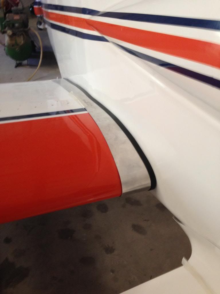

Old 03-10-2014, 11:28 PM
Derek Derek is offline
Join Date: Jan 2011
Location: Sydney, Australia
Posts: 86
Default Here is what I did.
Old 03-11-2014, 07:04 AM
Dean Pichon Dean Pichon is offline
Join Date: May 2006
Posts: 532
Originally Posted by STAP View Post
Thanks Dean,
Would you happen to have a picture, or can you take one and post it? I've seen other RVs with the fairing you describe and would like to compare.
I suspect my custom fairings are draggy. Plus they are a pain in the *ss.
Thanks!
Hi,
Next time I'm at the hanger, I will take a picture or two and post. The fairings, though, look remarkably like Derek's as shown in his earlier post.
