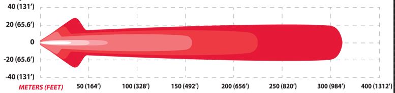

Hi Kahuna,
I do understand the differences, I just was curious how bright these were compared to other LED's out there since most other manufacturers represent their brightness by Lumens. In a world without marketing spin, LED's should be represented by both their brightness in Lumens and Candela.
Do you happen to have an Isolux plot of the output of these LED's, or something similar to the image below for light output and distribution?

Originally Posted by bullojm1 View Post
Hi Kahuna,
Do you happen to have an Isolux plot of the output of these LED's, or something similar...
You mean something like this?
