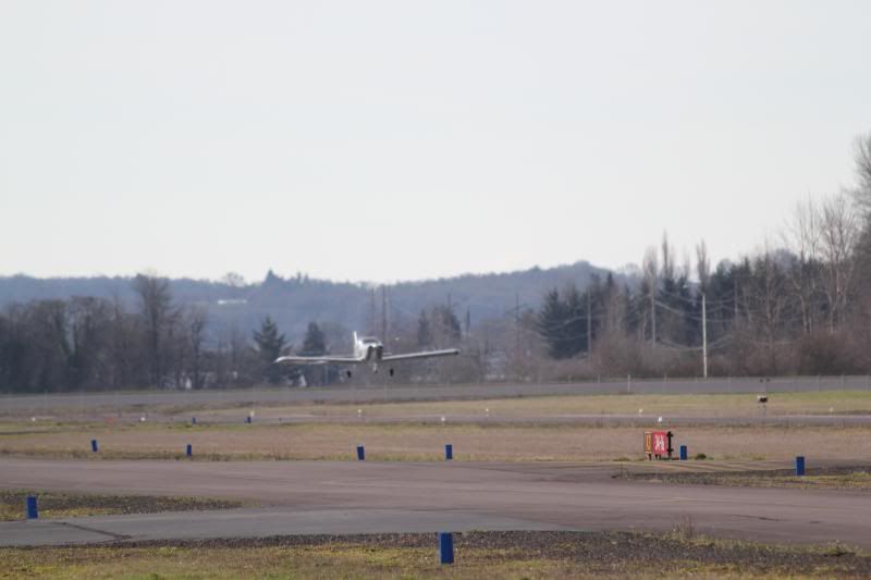

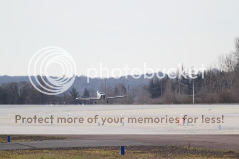

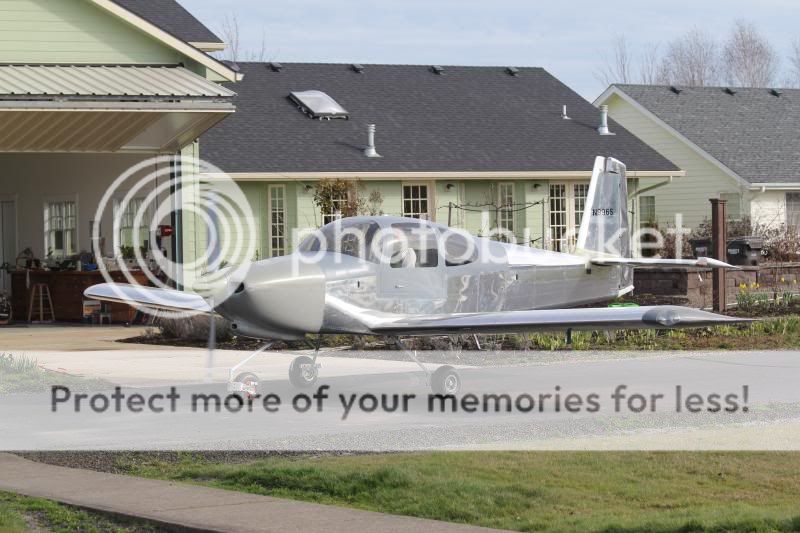

After 21.5 months of work, a new RV-10. Flys like a dream and lands not quite like a -6A. Thanks to Mike Seager for working with me Sunday to learn how to land these things. They do take a systematic landing approach compared to their smaller versions.

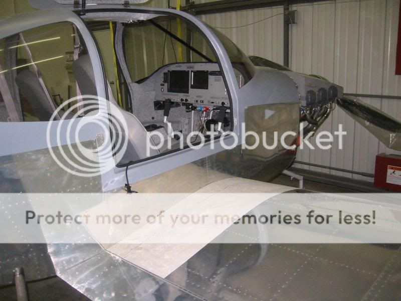

Quick build wings, slo build fues. Interior mostly by Aerosport and Flightline interiors. Interior is painted with Zolatone and makes a very light finish. Panel is 10" and 7" Skyviews, Dynon radio and PAR100EX for second radio and intercom with room for the latest Garmin 650 below the 7" screen later. Homemade plenum. Empty weight was 1624 on the EAA chapters digital scales.
First flight had one issue with a radio and the normal high cylinder temperatures. Second flight the engine was showing good signs of breaking in.
Will fly a lot this summer in an unpainted state, paint can wait til next winter.

Wow - squashing that little green monster. How about a few more pics of the interior/panel??? Inquiring minds like those juicy details!
