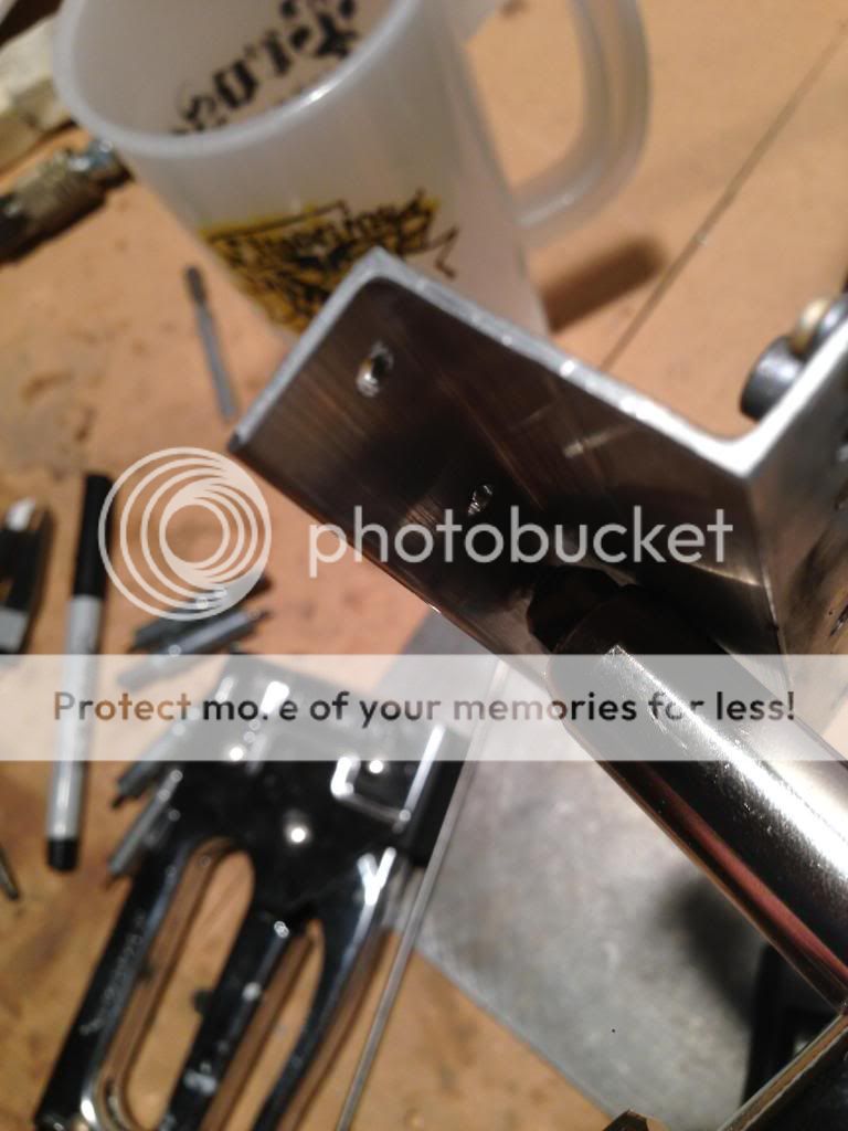

A little motivation has got me back into building my kit- and reminded me of what de-motivated me in the first place... The gosh darn Z brackets.
After the first attempt and fail with the Vans instructions, I proceeded via the Chec.... Ahem the Hurlbut Method and still wound up with some bad results:
As you can see the holes are way too close to the spar web, and the pop-rivet tool (pre-shaved) will not fit:
The tank fit beautifully and the inboard bracket aligned well:
I'm hoping for a "build on" from the community- will this tool
http://www.averytools.com/prodinfo.asp?number=5012
be the solution?
Thanks in advance VAF.
DB

I would. Find someone willing to loan it out.
I had a similar problem and had to remake a full set. Mine was shifted off top to bottom by 1/32". The Hurlbut method worked perfect for me.

If it is just a matter of pulling a rivet in a tight spot, EAA Hints for Homebuilders has good info
at ~5 min point in this video….
http://www.eaavideo.org/video.aspx?v=1432781652

I have that tool and it is very useful. I've found several situations where it was the only thing that would work.
Build on!
