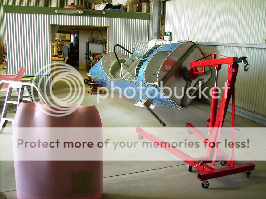

Default What is a good height?
May not be for everyone, but I use this plenty.
Adjust the height, and/or rotate (8 positions) to suit.
Paul.
