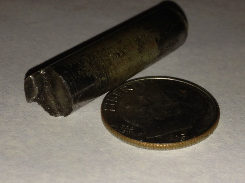

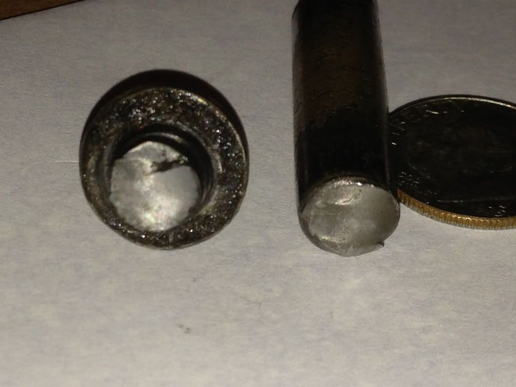

I believe my bolt failed into three pieces. I'll call them the HEAD, BODY, and THREAD&NUT. Reference coin is US Dime.
I cannot find HEAD.
Here is a picture of the two pieces I have. THREAD&NUT was found under the plane at the failure place. BODY was in the strut and came out with a relatively light tap with a punch.
I believe these are the mating surfaces of THREAD&NUT and BODY
I believe this is the end of BODY that would have been attached to HEAD

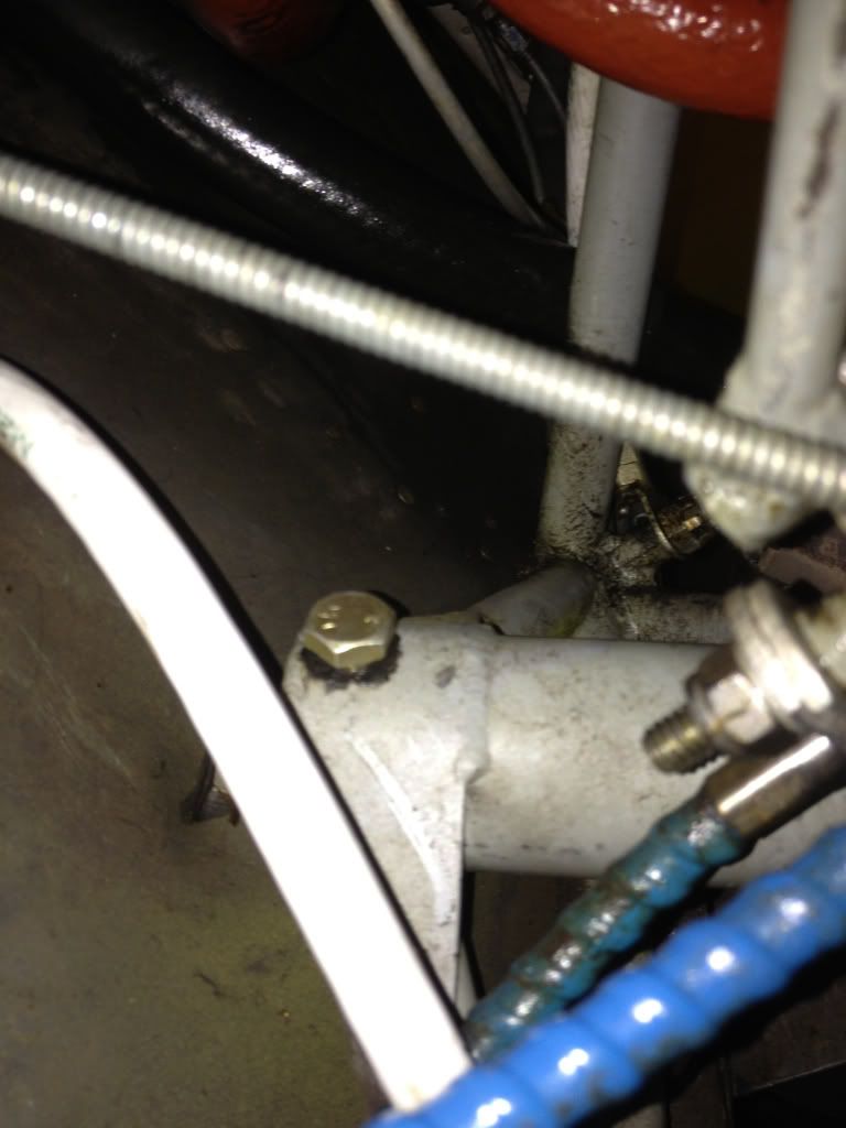

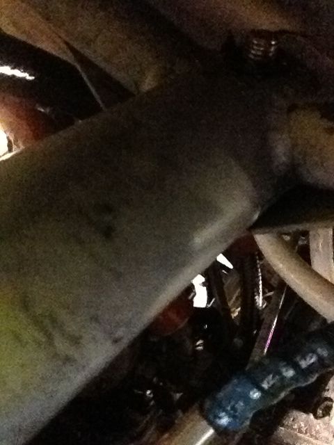

And here are two lousy angle pictures with a temporary bolt to keep my strut in place while sitting in the hanger....
Top of temp bolt
Bottom of bolt (threads - no nut), odd orientation in upper right corner

That doesn't look like a ductile shear failure to me, especially that jagged edge on the head side.

It's somewhat difficult to see the fracture surfaces in the photos but at first glance it looks like the nut end failed from fatigue and the other end failed by tensile overload. We'd have to be able to examine the surfaces better to be positive.
If this was the failure mode I'm a little surprised to find the nut. What usually happens is that the strength of the fastener reduces as the crack progresses until there is a final tensile overload that causes the ultimate failure. I suppose that both failures could have happened almost simultaneously with the head end being torn off after the nut end failed.

Here is my theory for the experts to diagnose.......I am guessing there were 2 separate failures. The first one was the head of the bolt failed in tension due to over torqueing and vibration in the engine mount. The bolt was held in place by friction but the sheer strength was significantly weakened. Some time later, due to all the sheer being transferred to the nut end, the nut finally sheared off.

From the pictures, it looks like the failure is a typical fatigue, about half of the fracture surface is smooth (fatigue zone), while the other half is rough (due to instant fracture). This is typically caused by repeated bolt bending. It is hard to say what really caused this since this type of failure is rare for RV fleet. If I have to guess, it is mostly likely the bolted joint was loosened due to vibration. Especially if the bolt is not re-torqued during annual.
