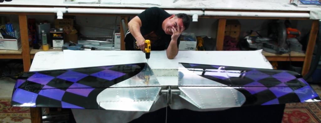

As much as I hate to do this mod, I think it will make the forward spar much more attached to the fuse. The forward spar is only held on by 16 rivets by way of HS 714 and then on to the sheet metal forward spar. The mod captures HS 710 (upper angle) and more than doubles the amount of rivets grabbing the forward spar.

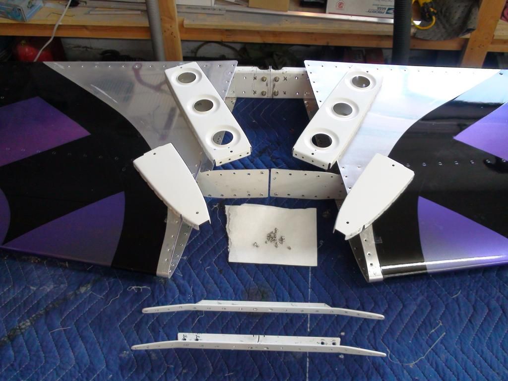

I have successively removed the HS 404 and 405 ribs today the hardest part was drilling from the rear towards the front to remove the rivets that hold the 404 and 405 together. I used a 12 in 40 drill, flex with a rag holding the bit perpendicular to the flange 3/4 the way through, drilled the manufactured head slightly with a 30, took a sharp wood chisel to remove the head, took a 16 nail turned down to fit in the 40 hole, taped to the rivet gun on 20 psi, taped a nut on my tungsten bucking bar for the back stop dolly and pulled the trigger ever so slightly. Clean holes! I got the procedure idea from Walt's post but had to come up with an idea to do this single handed.

well, kinda getto, but it worked.

So if you did the HS like me, the manifactured heads are facing rear, and HS 405 is installed so that it is dificult to drill, I had to bend the 12inch 40 drill while drilling to get a straight shot in the MH of the rivet. These are the tools I used. Kinda back yardish but it worked.

no holes were harmed in the making of this film...pic
