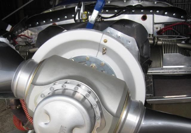

We're installed the spinner today and came across four holes (2+2) I can't find anything about in the manual?
They are in the aft bulkhead and one on each side of the black line in this pic. They go through both halves of the bulkhead so it seems logical that they schouled be used for bolts for example?
Schould there be AN-3 bolts and nuts here maybe?
Maybe I've missed something in the manual?
I can't remember anything regarding these four holes when we fitted the spinner a few years ago (must be getting old ) so hopefully someone out there can help me out?

There should be a bolt and nut on those holes, i don't recall the size but if you call WW I am sure they can tell you. Thees holes hold the two spinner back plate halves in place.

It's screws and nuts, nut on the inside otherwise it will rub on your cowling. The screws should have come with the prop kit, they are low profile phillips, for clearance between the spinner and cowl. Ask me how I know?

To get even better clearance countersink the aft two...

... alot guys. Those low profile screws are going in tomorrow for sure!
I'll even countersink the aft two ones. Great idea!

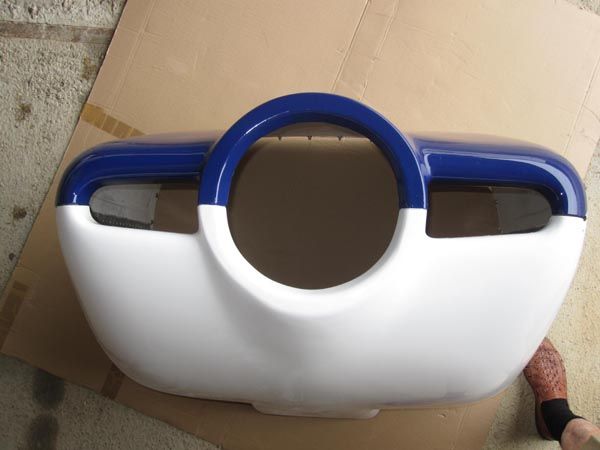

Here's the rest of the colours of the plane:
Oooops.... guess I'm hijacking my own tread...

Washer head screws are supplied with the prop. I installed the screws with the head outside as Paul K suggested to clear the cowl lip which I narrowed anyhow. The instruction manual says head inside.
