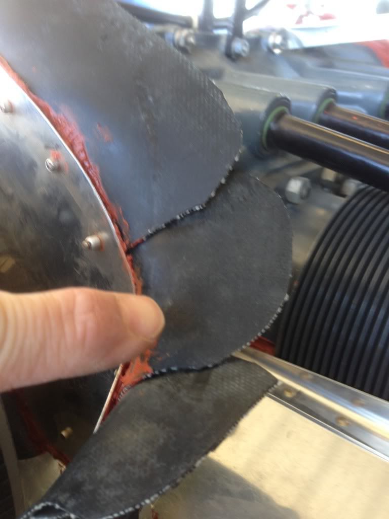

On my 7 I made 4 pieces of baffle
With the cowling in place I marked both inlet cowl scoops on to the metal that goes up the sides outside the starter ring
Then I added the baffle material from where the rear of the fiberglass cowling splits around the prop shaft back to the area where it would overlap the baffling material on behind the starter ring. I mounted it down 3/4 inch from the inlet scoop line and ran it up diagonally till it overlapped the back starter ring baffle
Starter ring baffle
I ran two separate pieces on each side of the baffle ring back metal each one ran up to the metal baffle support which I notched out of the rubber so these two rubber baffle could overlap by 3/4 inch. I mounted mine on the aft side of the metal baffle.. I have seen them mounted both ways but for the rubber to bend backwards was just more natural
I put the cowling back on and made sure that the side rubber baffle would be on the outside of the back ring baffling... Like you stated I only have about a 1/4 inch max between the inlet scoops and the metal baffling around the prop extension. But with a little marking I got the dog ears to over lap so the side rubber would push up on the back rubber....

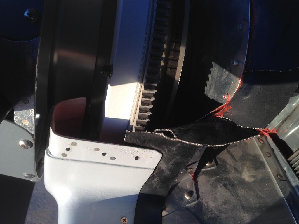

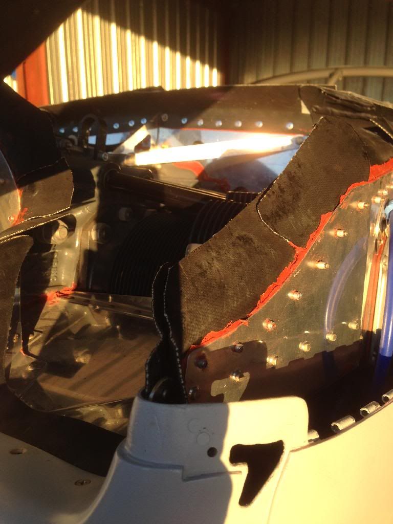

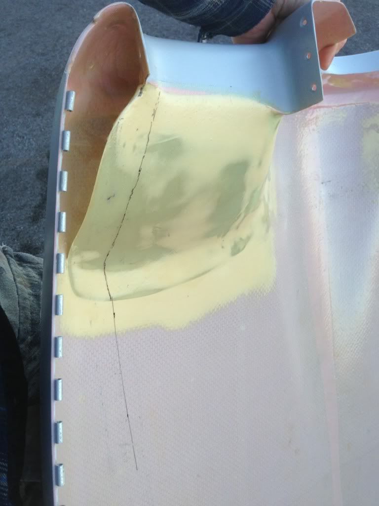

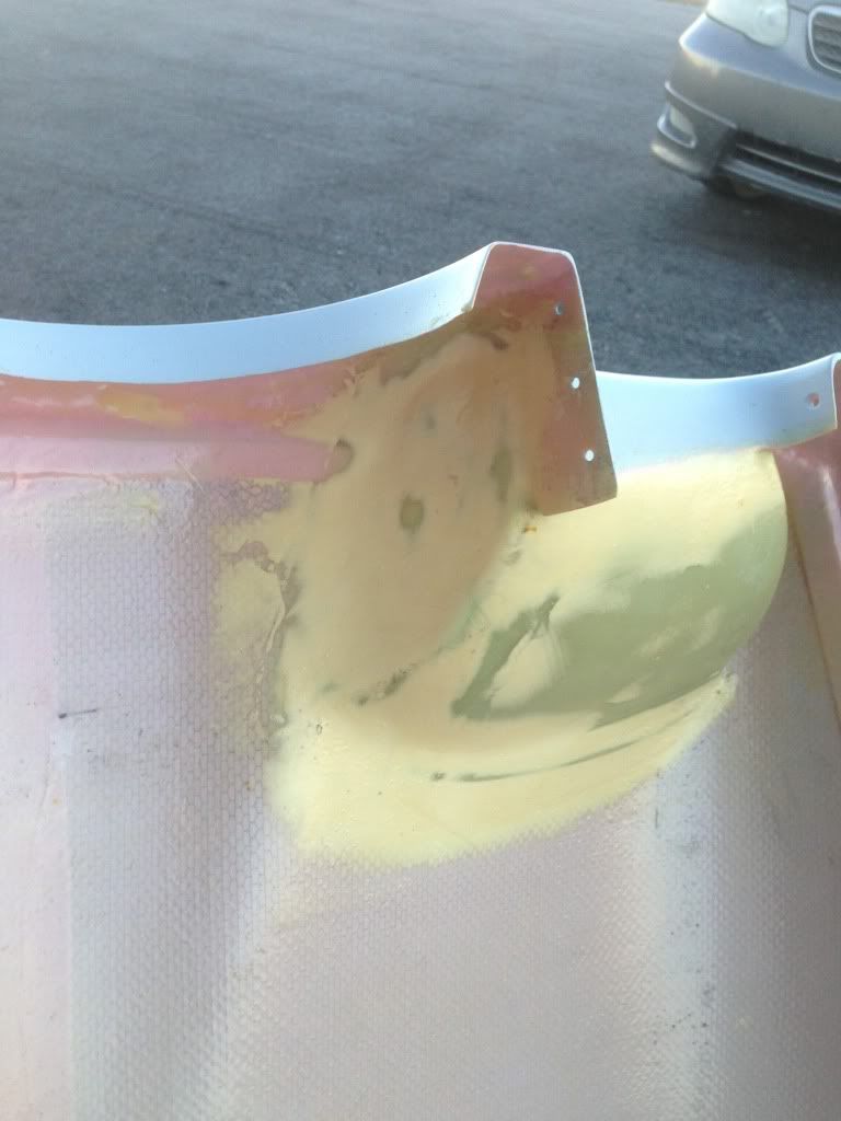

I had to extend the upper fiberglass ramps inboard several inches so the baffle material had something to lay/push against. I used blocks of blue foam glued in place, I glassed the entire side as well just because. Pic shows the extra glass, again the extra glass perpendicular to the inlet ramp isn't necessary.
Line drawn on the outboard ramp shows the position of the metal baffling. If I would have originally positioned the ramps further inboard I probably wouldn't have had to the the glassing on the inboard side.
Baffle material.

You can build it either way, it may take several tries but use poster board/pop+beer boxes to simulate the baffle material. As long as the incoming air pushing against the baffle material makes a seal and not a leak you're good.

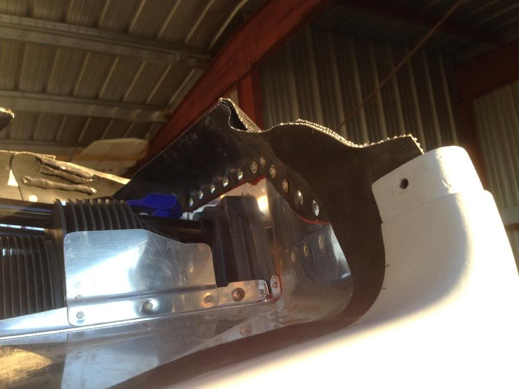

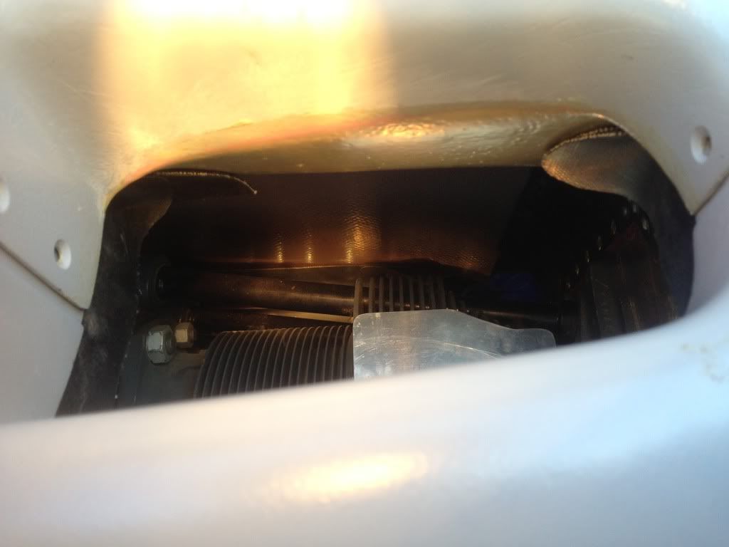

I sealed mine on the air ramps. To help me visualize how to seal these I placed just the top cowl in place over the bare aluminum baffles. I taped a sharpie to a popcicle stick and traced a line where the center metal baffling meets the top cowl and top air ramps. In my case I had to extend the edge of my upper fiberglass ramps inboard so the rubber baffle material had something to push against. Kinda hard to see in the pic but if your imagine an arc from the top inboard corner of the air inlet on the upper cowl and trace along the inboard horizontal edge of the upper inlet ramp where it meets the top cowl, that is where my baffle material is sealing (riveted to the inside edge of metal baffling and curving into the engine and air inlets).
Couple more pics.
If you look close you can see the pice of baffle material that is connected to the lower cowling inlet (just like the plans). There is a little ear (forward most baffle material) the small part tucks in behind the cowl and the larger ear pushes against the upper air inlet ramp. The incoming air pushes the material against the lower metal inlet ramp, sides of the metal inlet ramps, against the top fiberglass inlet ramps, and further back the material is pushed against the upper cowl.

I sure appreciate you sticking with me on this.
Those show EXACTLY what I needed to see.
The rubber has to be lower on the sides of the center baffle in the
front to match the angle of the air inlet ramp. The rubber on the lower
cowl over laps and is held in place on the vertical by the ring gear by the
062 alum band and on the outside over the ramp then past the opening
into the little area of the outside points of the cowling.
Man oh Man you don't know how much I appreciate the pics.
