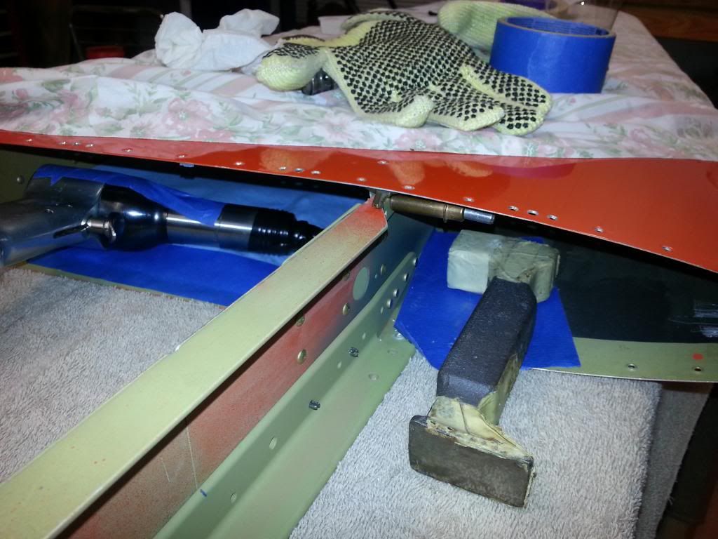

Okay everyone, we got the message on the crack-relief-flying off carriers etc.
Now what is really needed is more info on how to do the fix. Bret, Mark, 2000, have all been very helpful. But please ---more photos with explanations.
Bret, did you drill out/off the skin at the rear spar?? Mark, how did you buck the fish mouth area rivets?? Difficult? easy?? How much time? Right hand-left hand-blind rivets???

Ed,
I think we've all been too busy installing the kit!
The hardest part is drilling/punching out those rivets on the ends of the angles.
I used an angle drill.
The riveting turned out to be a "non-issue" for me.
Up in the tight spots I used a 3X gun with a short (3") offset rivet set.
Take the spring off the gun, there's no room for it.
Turn the rivet set for each rivet to line it up with the gun in an optimum position to hold well. Tape the rivet set to the gun with electrical tape to keep it from rotating while riveting.
Nearly every rivet requires a repositioning of the set and tape it again.
I ran the air pressure on 60 but I'm sure some 3X guns are different.
It is quite a project. More than the few evenings I had estimated. I just reinstalled the empennage back on my 7A tonight.
I plan to fly tomorrow, it's been a long time!
As to how will I answer the "Stab Spar Mod" question. I will simply tell the truth. That I had two cracks and complied with the SB by installing the Vans kit.
Good luck with yours. Just take it slow and easy on the ones that are hard to get to.

Looks like Mark has the best idea by removing the root ribs for access. This would give more access to drill and shoot the rivets thru the spar web. Not to mention minimizing damage should the rivet set jump off and trash the spar web. I'd plan for a week of down time to do the mod based on 34 years of sheet metal experience.
Hi Jim,
Removing the ribs is not "my idea".
It's called out in the Service Bulletin.
And it would be impossible to do without removing the ribs.
Just didn't want to take credit for the idea.
