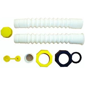

I have one good old gas can and 6 of those idiot vent-free abominations. I've seen various kits to fix them but don't always trust the vendor. I found a solution on amazon.com
The "Hi-Flo Gas Can Spout Kit" ... but i comes with a disclaimer:
this product is banned for sale in the following states: CA, CT, DC, DE, MA, ME, MD, NH, NJ, NY, OH, PA and VA
Thankfully, the white version is called the "Hi-Flo Water Can Spout Kit" and is available everywhere
It fits both of the common 5 gallon cans I have picked up from places like walmart.

I have undeleted this thread because it is very much RV related for those of us who are fueling our RVs with auto gas hauled from a local station in the plastic red cans.
I modified my cans by removing the interlocks in the nozzles and adding vents made from steel tire valve stems. The cans now flow great and the O-320 seems to be very happy on mogas. I sure am enjoying not having to clean the lead deposits off the black bottom of my plane!

Rural King has them also!
http://www.ruralking.com/ez-pour-hi-...kit-30051.html
Here is the video showing how to install a tire valve vent:
http://www.youtube.com/watch?v=0lcnwdIYEfI
