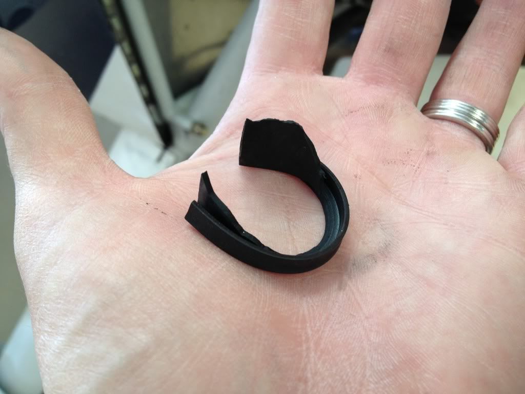

Seems I keep chasing the vibration dawgs. Today, after a thorough pre flight I took off and immediately noticed a little, oh so subtle vibration. Felt like something loose again with my exhaust system.
I check the hangars pretty close as they are a four into 4 so lots of hangar pieces. After I landed and before I took anything apart I asked my neighbor, RV7a builder/flyer to take a gander at my exhaust pipes and get his opinion.
He thought as I did that they were secure. So I took the cowling off and was very happy to find this...
I don't have any spare DG11's but Roger with the RV7a had a spare rubber insert piece.
Talk about an easy fix.
I think I need a more secure exhaust hangar system in general though. This is my second time recently that I've had hangar issues.
Also I have 3/4 OD tubing where the adel clamp attaches. I look up in the catalog and it shows a DG12 and yet this DG11 I am using seems right.
Look at that, hangar paraphernalia everywhere.

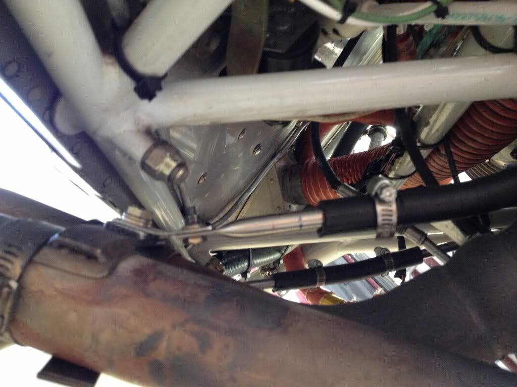

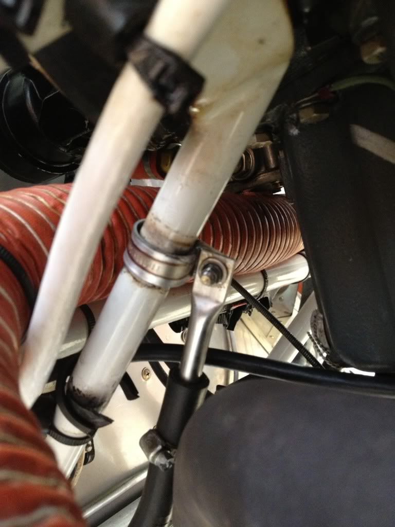

http://i59.tinypic.com/20zpvz9.jpg[/IMG][/IMG]Hanging the exhaust off the oil pan/engine is the preferable method so it all moves in unison. But on my RV8, i can't get a straight shot between the pan bolts and the exhaust on the left side of my crossover exhaust. So, I used the excess crankcase vent hose to hang the exhaust from the engine mount. It gives a flexible mount that allows the relative motion but stiff enough to hold it securely in place. Punched holes in both ends and through bolted the hose to the exhaust clamps from Vetterman. At the engine mount, i used two adel clamps to hold a 3/4 x 3/4 inch angle on each side and through bolted the tubing to the angle. I used Vettermans method to spread the two pipes, flattened stainless tube at each end with rubber tubing clamped between. 210 hours no problem. Several certificated aircraft use similar method except with tire wall rubber as the hanger.
