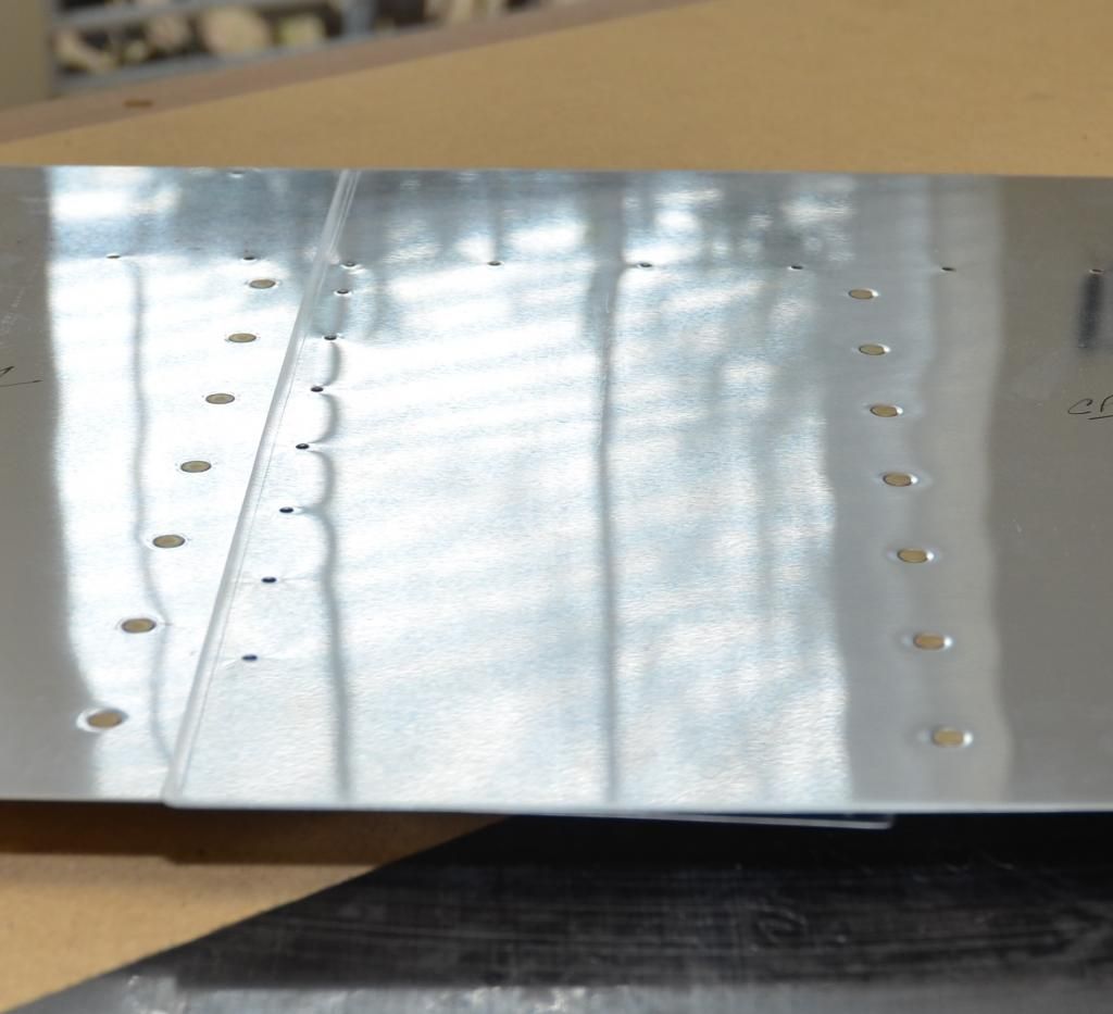

I'm still working on my practice kits getting comfortable with my tools before I begin my build. I read quite a bit of opinion on c-frame vs. DRDT. I got a DRDT with my tool kit and also purchased a used c-frame. I've tried many different adjustments on the DRDT, but do not get the quality dimples that I quite easily get with the c-frame. I've read where many folks say the dimples from a DRDT are as good as the c-frame, so I'm thinking that I don't have my DRDT adjusted properly. Any advice on adjusting the DRDT? This pic shows c-frame on the left and DRDT on the right. Kind of hard to see the difference in the pic - halos around the dimples on the right. It is much more noticeable in person.

When you finish pulling on the handle do you feel it go over center and lock like a pair of Vice Grips?
It does go over center, but it does not lock - handle will release when I let go of it.

Originally Posted by Jasonm View Post
Here is the link to setting up your DRDT.
http://www.experimentalaero.com/DRDT...20Drawings.pdf
Read the part in bold about not being able to over dimple.
Are you using the same die set as your c-frame?
Thanks, Jason. I set up per those instructions and have gone beyond the 1/4 past flush thinking it was under dimpled. Yes, same dies used in both.
It won't lock, but you should also see the arm move upwards ever so slightly.
bob
I have mine set up to lock every time. I can let go and it stays compressed. Not a bad dimple yet.

Thanks, gents. I?ve messed around with various ram distances ? up to the point of not being able get the handle to fully close. I?ve continually increased the pressure thinking that my results looked under-dimpled, and per the instructions that state you cannot under dimple with the DRDT. The owner sent me a PM and I will discuss further with him. I am sure the issue is one of operator error. Thanks for the advice.
The instructions state that you can't OVERdimple. You most certainly CAN underdimple.
