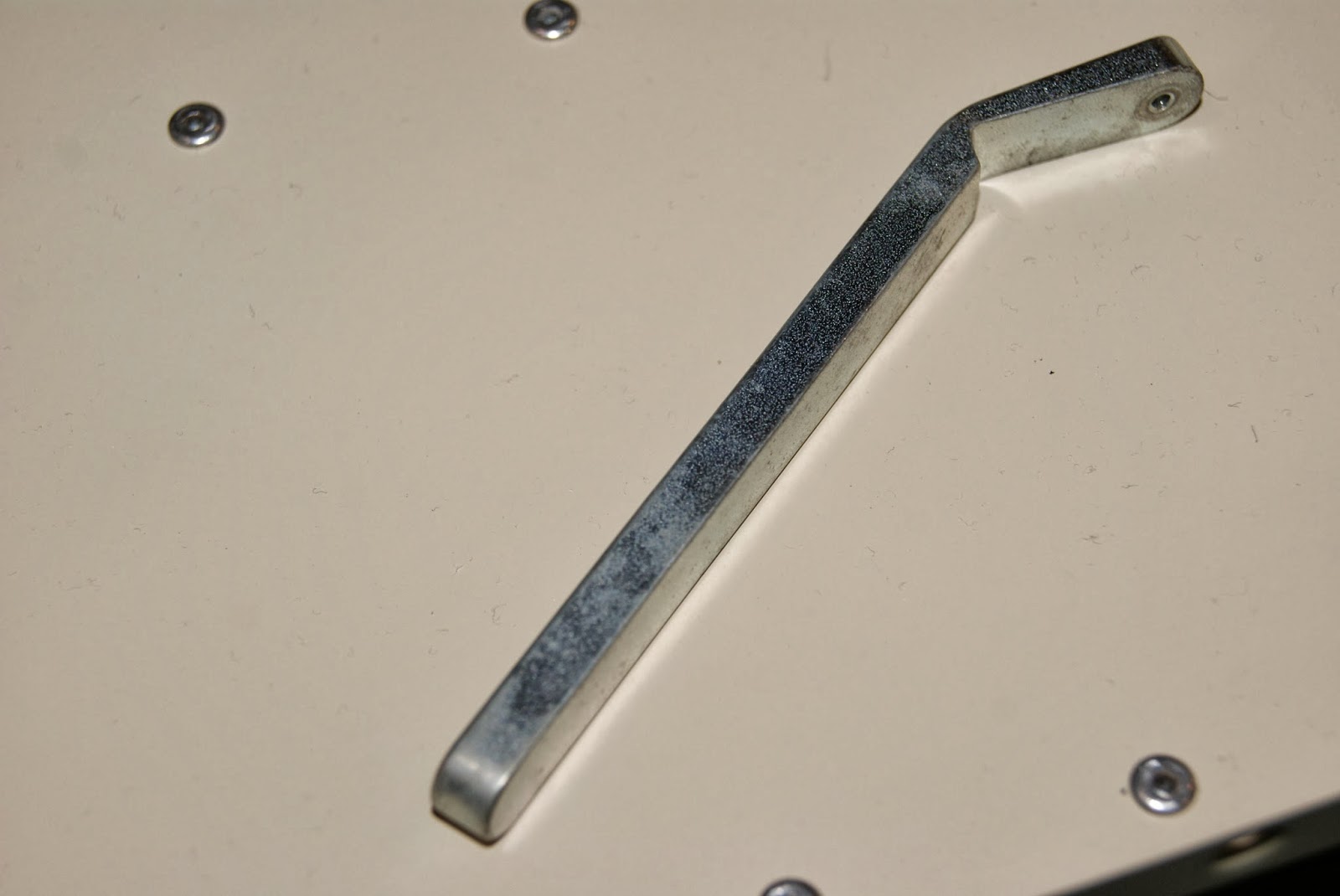

I could make my own but wondering if anyone know who sells these tight fit riveting tools?
http://www.dogaviation.com/2013/11/a...shing-mod.html

You can get one from Avery
http://www.averytools.com/prodinfo.asp?number=P26A

I linked to the picture:

I cut a simple wedge out of 1/2 x 1/2 aluminum bar stock and drilled a hole in it. Super simple and worked like a charm. Only trouble is that they're easy to lose if you don't watch em when the rivet pops so make a few at a time...
+1 - hand made are smaller too and leave more head room for the tool. I love tools, but the hand made served me better, not just cheaper.
