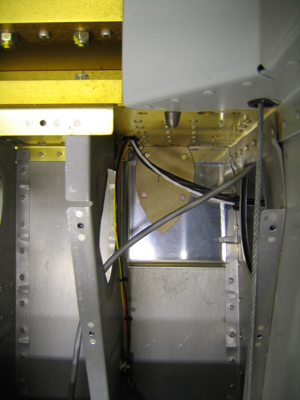

I have reviewed all posts on doublers and this is what will be used for a Comant bent whip mounted behind the spar on the outboard cell.
Here is the location of the (to be) finished doubler.

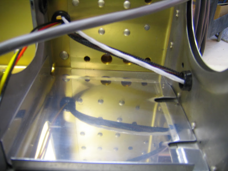

Hopefully a better view of the doubler in position. Note that the rivets along the bottom of the spar flange, and on right along the outer skin would be drilled and common rivets used to secure two sides of the doubler.

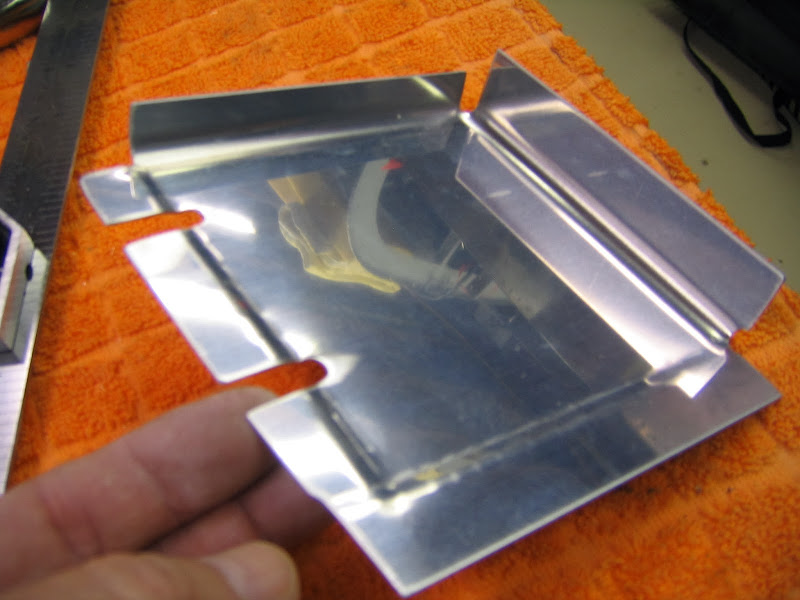

This is the best shot of the doubler alone. The two slots are to clear fluting on the side skins on the floor. The joggles go the right direction although it does not appear so.
I have looked at AC43-13 but don't see where guidelines for rivets in the flat area are stated - some help there would be appreciated.
How does this look, too much? Problems/issues? It just appeared easier to joggle and use existing rivet locations for appearance and better structure. The part will be alodined prior to riveting.
Constructive comments invited.

That should work fine assuming you have checked clearance between the connector/cable and the aileron pushrod in all possible control positions.

No holes drilled yet, so I will double check the clearance. I did not precisely check this installation detail. I always thought the backup was a 90 deg BNC.

For what it's worth, here's a shot of how I did it in the -8.
Antenna / aileron pushrod clearance was close, but worked out ok with a few tie wraps...

That said and back to the topic at hand, Bill's modification appears to be something I don't see any problems with other than what MEL mentioned...just ensuring the cable doesn't rub on the pushrod. RG-400 has a fairly reasonable and tight bend radius and a few zip ties, cable clamps, or other strain relief type of mounts should help it from having any interference issues. I might take an alodine pen and coat edges/holes, but other than that I have seen many installations in similar areas without much difficulty. As Bill knows, just keep the other antennas clear of that one by a couple/few feet and you'll be golden.

Just remember with that forward position of the doubler against the spar carry through bulkhead, you might have issues getting the wing bolts in place. You need to be able to tap those close tolerance bolts in there. I put my antenna doubler farther back in that area and it was still a bit tight getting the wing bolts pushed into place.
