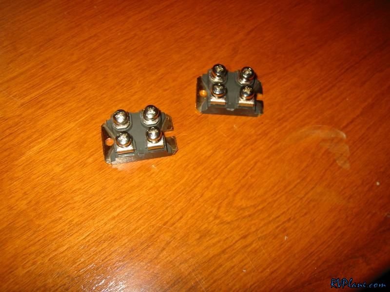

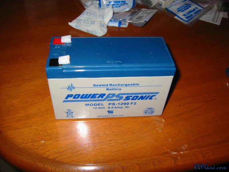

I went BIG on my aux battery - 9 Amp-hour (PowerSonic PS-1920 F2 - $24)
I isolated it from my main bus with a schottky diode (IXYS 45V 2X59A, about $21.09 at Mouser.com).
Before I start my preflight check I flip on my Aux Battery Bus which powers essential items (GRT EFIS's and Garmin 430W) to make sure the aux battery still has some juice left in it. Every annual I run it down. I am amazed I get over an hour!
Total cost is less than $50, and replacement batteries can be had anywhere. Plus you get over double the runtime than the overpriced $375 IBBS. My system has been going strong for 3 years now without an issue.

I did a 7.5Ah battery that is exactly the same size as the one in Mike's pic. When I replace it, I am going with the 9.0Ah one.

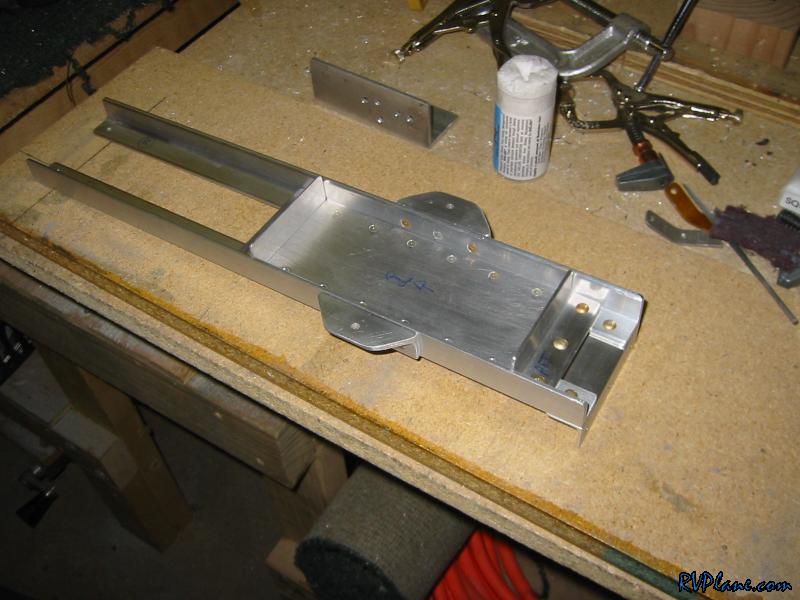

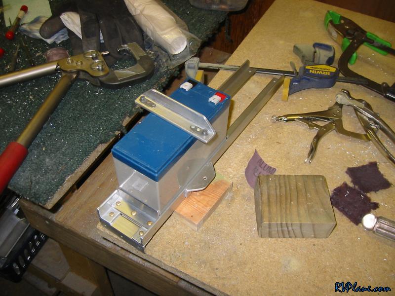

Originally Posted by Thermos View Post
Where did you mount your aux batteries?
Dave!
I mounted mine between the subpanel and firewall. I made a bracket out of leftover longeron material.
Mike Bullock
RV-7, Flying!
http://www.rvplane.com
EAA Technical Counselor

My craddle looks similar to Mike's just out of 3/4" x 3/4" x 1/16" angle and not as long since mine is mounted with the side of the craddle instead of the bottom.
