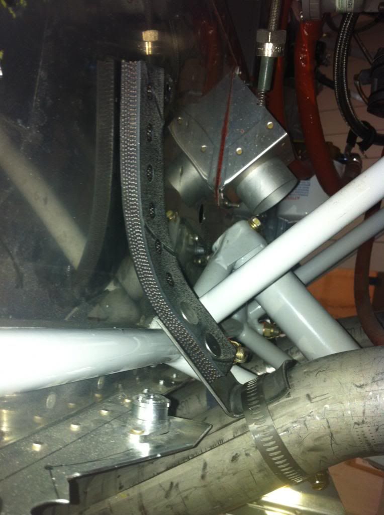

I too did not like the small tubes running all over the
engine area to the pipes.
I think I am going to hang my tubes like the photo using tail pipe
hangers from Autozone. SS hose clamp and two bolts through the
firewall stiffener that runs at a 45 on each side.
Still trying to decide on which way to turn the cradle on the pipe.
Let the comments begin.
Bert

Excellent Bert...but do buy a better grade of hose clamp. Try the ABA brand from Wicks.
