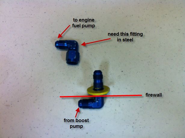

I am changing my through the firewall fuel fittings
from alum to steel. I found the bulkhead fitting but
I can not find the 90 deg fitting. Spruce has only the one
like I have in alum.
Why do I get the feeling they don't make the 90 in steel?
Any help or direction appreciated.
Bert
RV-9A ?Pearl?
Working on Instrument ticket

If these guys don't have it, I'm doubt anyone does
http://www.anplumbing.com/

Might try automotive sources (Summit, JEGS, Earl's fittings, Russell fittings, XRP fittings, etc.). Generally cheaper, very broad configuration selection, and I have heard if no quality issues with mainstream automotive (hot rod) parts. 95% of my fittings are of this sourcing. Zero problems in 13+ yrs and 1500+ hrs.

Aircraft Spruce carries the part you are looking for, it just isn't easy to find.
On the Aircraft Spruce web site, search for:
AEROQUIP FITTINGS FOR FACET PUMPS
or here is the link:
http://www.aircraftspruce.com/search...PUMPS&x=28&y=9

Check with B&B aircraft (913) 884-5930

Thanks, Speedway had it in AN6 which what
what I needed.

Most industrial hydraulic suppliers will have it.
