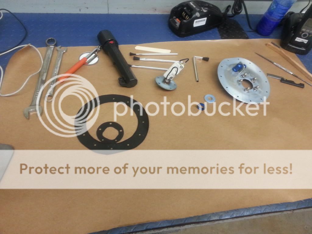

Old 12-20-2013, 07:39 AM
Randle Randle is offline
Join Date: Dec 2012
Location: Atascosa, TX
Posts: 106
Default Tools I use
Originally Posted by Kevin Horton View Post
Should I try to roughen up the old Proseal a bit with sandpaper, or just leave it alone?
Any other advice before I start the leak repair?
Before you remove the access cover, make sure you have the leak exit point nailed down to the exact point. It is not uncommon to open the tank and apply sealant to the point on the inside where you think it would be coming out and later after you find it is still leaking, open it back up, use blowback, and find it was actually 6 inches outboard and was ?running? under a fillet or seam to the exit point.
Once you have the exit point, open the tank and apply a water/dish soap mixture (similar to what tire shops use to find leaks in your car tires) to the inside of the tank in the area where you think the leak is originating from. Then using compressed air, I use 20-60 psi progressively until it is found, blow back at the exit point until you see the bubbles form on the inside of the tank from the water/soap solution. Then remove the sealant in that area and clean it with MEK. I strongly believe in removing the sealant instead of topcaoating due to many times the sealant in the origination point has failed to adhere causing the leak anyway. Why lay good sealant over bad, what might the end result be? Once area is cleaned with MEK, do as others said and rough up the sealant near where you are applying the new (I use a metal bristle brush as seen in the pic), clean it again, and lay a thin coat of adhesion promoter (PR-148, The blue stuff in the top right corner of the picture) where the new sealant will be and anywhere you will overlap the old with the new in the area. Let that dry out for 30 minutes and apply sealant with a smooth overlap. I love using acid brushes (4 seen in the pic) to apply sealant. They are easily bent to reach around into hard to get corners and are only 15 cents at a local hardware store.
