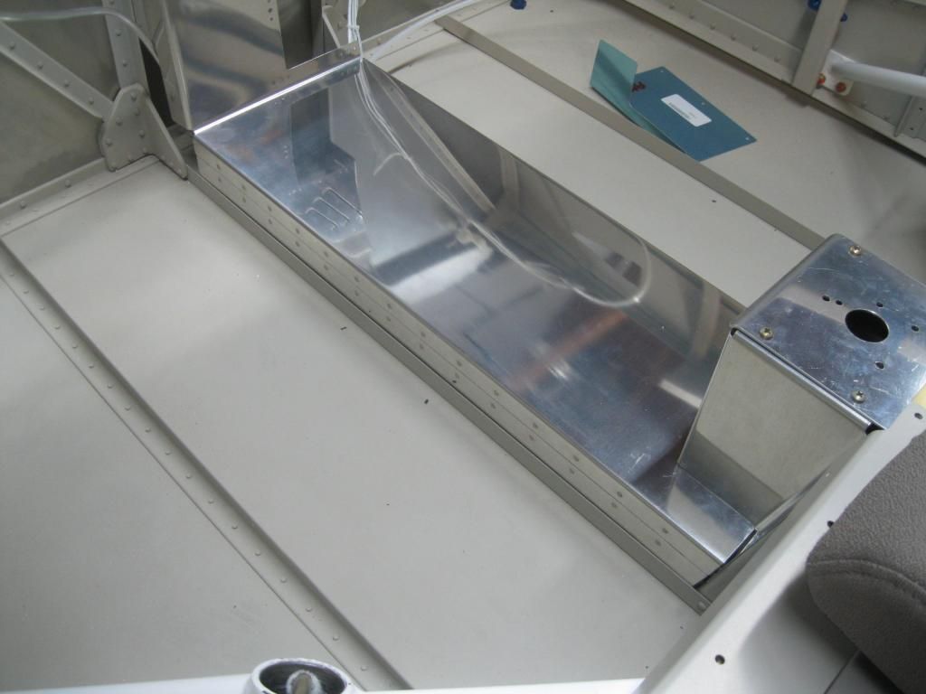

I've posted this elsewhere, but I thought I'd put it here for better search-ability.
I mounted all the components inline and extended the center cover upward. I wanted to get rid of the doghouse.
On the pump, one of the Adel clamps fits easily. With the other, I cut off a section of the rubber insulator so the clamp could squeeze between the motor and the bypass assembly.
I mounted the pump to 1/8" x 1" flat stock with countersunk screws. The stock will be secured to the floor with ProSeal and rivets. The filter has its own foam-lined cradle made of aluminum U-channel.
