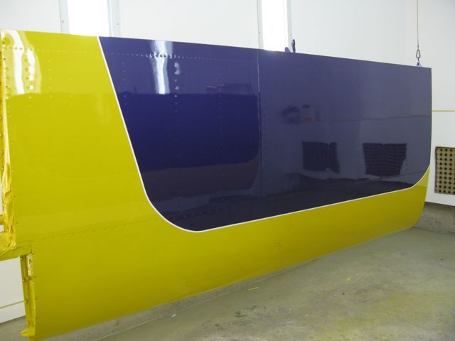

Here's a shot of David Howe's Rocket. This plane has the best riveting I've seen thus far. In fact, the whole airplane was so interesting I plumb forgot to ask about his riveting technique - although I did get to see some of his custom frames, including one extremely stout one that used the 6,000 lb. pneumatic squeezer (the common squeezer is only half that).
There's no filling on his wings.
Dave
