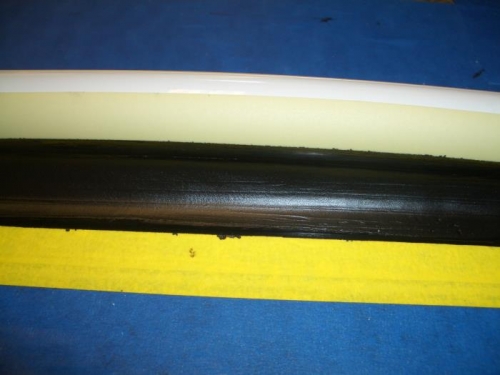

This mirrors my experiences exactly. the only things I'd add are that I did mine in 2 stages - a "rough" bead just to hold the thing in place then a cosmetic stage the next day to make it look nice.
My only real problem was that after the 1st stage I managed to get the fineline tape trapped in a few places under the initial layer of sika - a real PITA to get out.

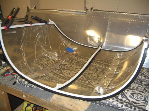

Pics
http://www.flickr.com/photos/115470196@N06/
I compressed the frame by 12mm as it dried - the "springback" was about half this (so the frame at the rear was narrowed by 6mm (1/4").
What I did to prevent getting the tape trapped: I took a razor blade and dulled&smoothed it using a durburring wheel so that it wasn't sharp anymore. I ran the thin but dull edge through the Sika using the tape edge as a guide. Just in those places I was worried it may get trapped. This cut the wet sika and made it easy to pull the tape later. The blade was not sharp enough to scratch the plexy without a good amount of force.
As an update, here are some pictures of the finished slider. Not perfect, but I am happy.

Default A couple more thoughts / ideas on this
I've pretty much got my slider canopy finished now - got to say I'm delighted on how it turned out.
For what it's worth here's a few things that worked well for me in getting around some of the snags that can crop up.
1) Problem - I struggled to get the canopy side skits to lay flat on the fuz side.
Solution - I Sikaflexed the skirts to bottom edge of the plexi and the lower canopy frame rail underside edge only at first.
Once this had dried it formed a "hinge" that I could use to hold the skirt in the correct place against the plexi and canopy frame but at the same time allowing me to force the lower edge of the skirt down against the fuz.
I then put a bead of sika along the top edge of the frame, used the above to force the edge down before it set and hey presto, once set it holds against the side perfectly.
2) Problem - The lower front edge of the side skirt scraped along the top side deck of the fuz as the canopy slides back
Solution - I cut some 1" wide strips of 30 thou aluminium and shimmed up the slider track along the rear half of its length. As the canopy moves from open to closed it lowers along the track by 60 thou (2 shims) and the canopy skirt moves down just enough to cover the gap where the notch is at the front edge
3) Problem - Getting a seal around the 2 halves of the canopy between the "bows"
Solution - When I smeared the sika in to bond to the frame it left a nice 1/2 round depression. I bought some 1/4" closed cell soft neoprene round extrusion and found that it fits perfectly into this recess. Glued in with thick Cyno it makes for a perfect seal (Not yet flight tested though mind). I've therefore not bothered with the external cap strip at all.
