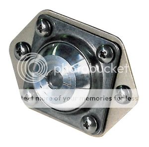

Could anyone give me dimensions (length, width) of these eyeballs?
Neither ACS or Vans have info--called Doubletee, no one there returned my call. I want to use these on the firewall of my QB-8 (has the prepunched holes) for throttle, prop, mixture--just not sure they will fit. Thanks in advance to the all knowing board--

The actual ball has a 1 inch diameter, and the installation calls for a 1.125 inch hole.
The four main mounting screws are on a 1 inch square pattern.
The other two mounting screws for the backplate are 1.625 inch apart.
The screws are #4-40.

A PDF file is located here,
Just got done drilling three holes in my firewall about an hour ago.
http://www.doubleteeproducts.com/products.html
