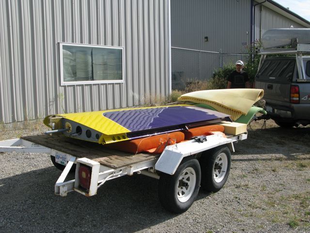

Before paint I moved the wings on the stands with lots of ratchet straps and padding. I put a bolt through the spar on each side of the support.
After paint I was concerned about abrasion on the fresh paint from the stand so I used some cushions and mattress out of an old RV and an old foam mattress topper and laid em flat.
No damage either way...
