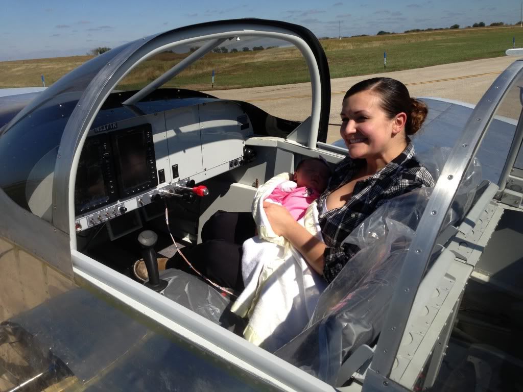

Plain old Proseal worked great for me, I just masked everything off with electrical tape and applied it with a syringe and smoothed with a gloved finger. Left it overnight, peeled the tape and touched up anything I didn't like. Preparation must be key, it was way easier than I thought. About 30 min to put down the tape and another 3o mixing and spreading proseal. #1 rule: if proseal gets on a glove, get a new glove.
This is the only pic I could find of the finished edge (may have to zoom in), it's on the canopy and windscreen about 3/32 wide.
