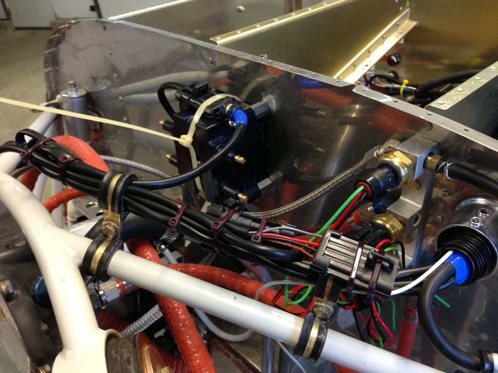

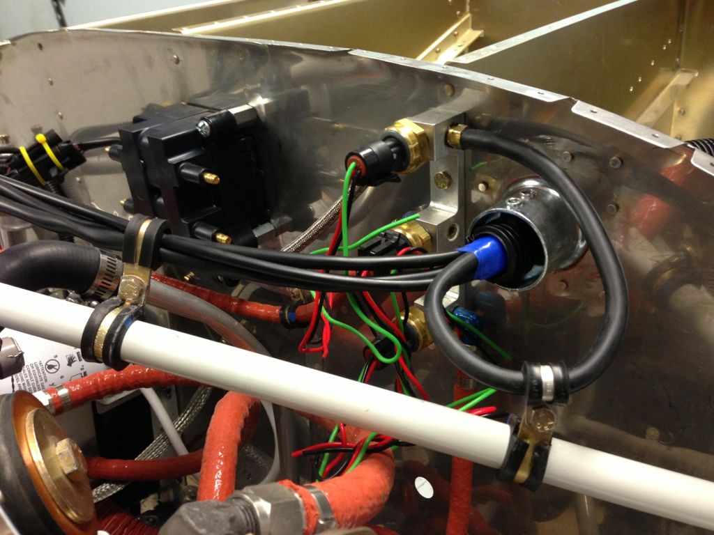

Not for the Dynon, but I used Van's recommended spot for the manifold on the firewall. It was pretty easy to branch out to the various pressure ports from there. Manifold on top (also branched off to EI Manifold sensors), oil in the middle and fuel on the bottom.
RV 7 400 hours and counting

NICE LAY OUT CRABANDY. great PICTURES FOR SHOW AND TELL HERE. funny ABOUT AUTO CORRECT. It changed Crabandy to counterband! lucky I caught it and changed it. Much clearer how. Site getting pretty good hits. I guess its a show how the newly built panels are going glass. We are going to have a field day when its time to sell the plane. I hear the market is finding a lot of non-builders are buying our planes, and thats way cool for the bottom line. Ron
