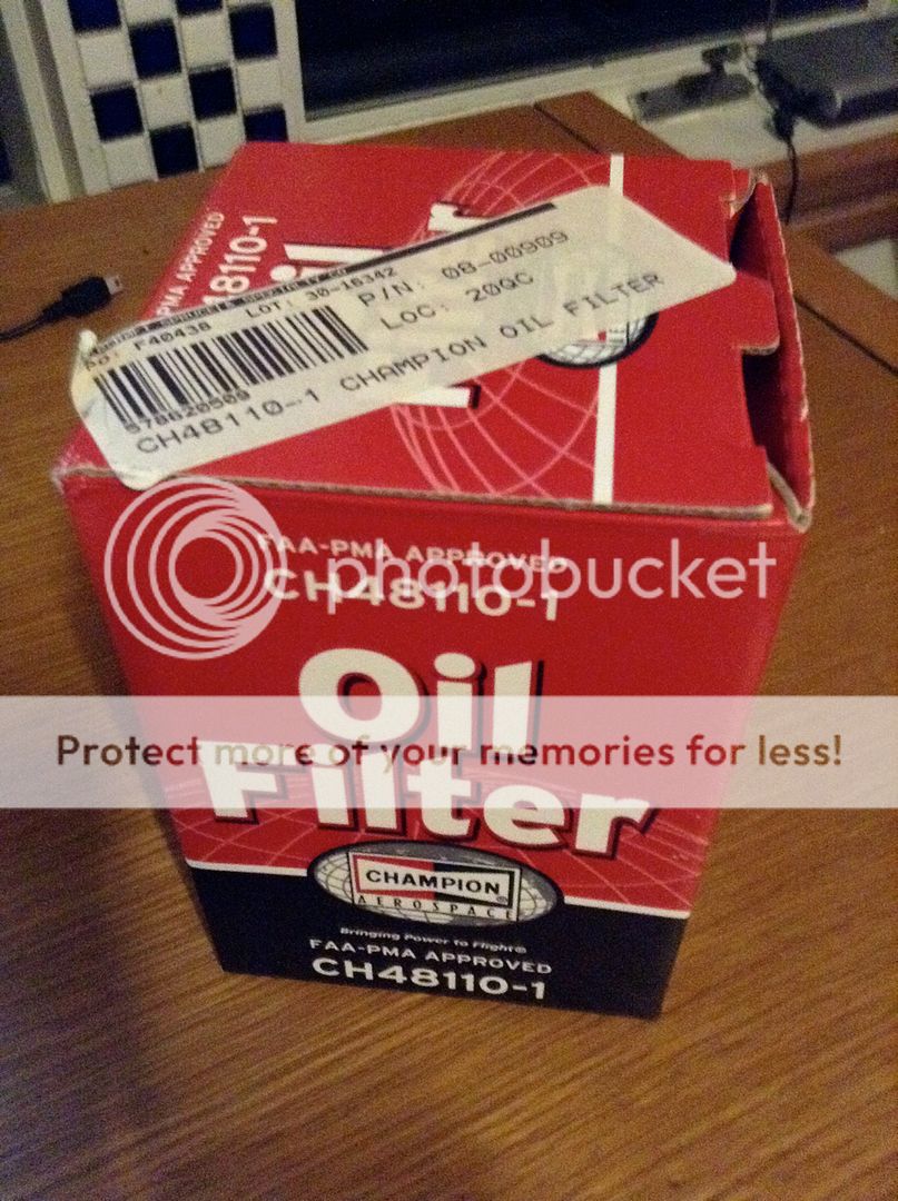

Hello folks!
Appreciate if someone could tell me which of these oil filters goes with Lycoming IO-320-D1A?
Which of these:
http://www.aircraftspruce.com/catalo...pionfilter.php
Thanks in advance!

I know this older post is concerning 540's in RV-10's but the discussion is really pertinent to why anyone would use one filter (48108) over another (48110).
http://forums.matronics.com/viewtopi...b18ef13ac51908
Ditto this. You need to see what your engine manufacturer specifies. My Aerosport 0-320-D2A (which is more or less a D1A) requires a 48108. Just because one D1A (or D2A) uses a 48110 does not mean that all do.

if you have the angle adapter they usually use the -108.

NAPA Gold 1515
