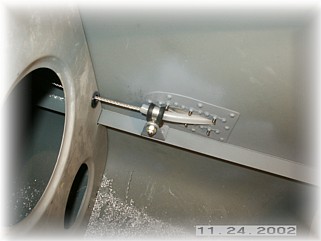

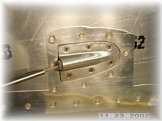

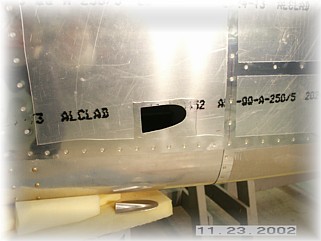

I copied Sam Buchanan's idea from his build log. Easy and quick to make.
http://home.hiwaay.net/~sbuc/journal/fuse8.html
Information is about half way down the page

Don't rivet them on until you have run your rudder cables. The cable ends are too large to fit through the openings..... guess how I found that out.

Build a backing plate and cut the slot big enough to allow you to replace the cable if necessary. Affix the cover with #4 screws and the entire assembly is serviceable if needed. You can go here for detail step-by-step instructions.
http://www.rocket.pflanzer-aviation....er Cable Slots
