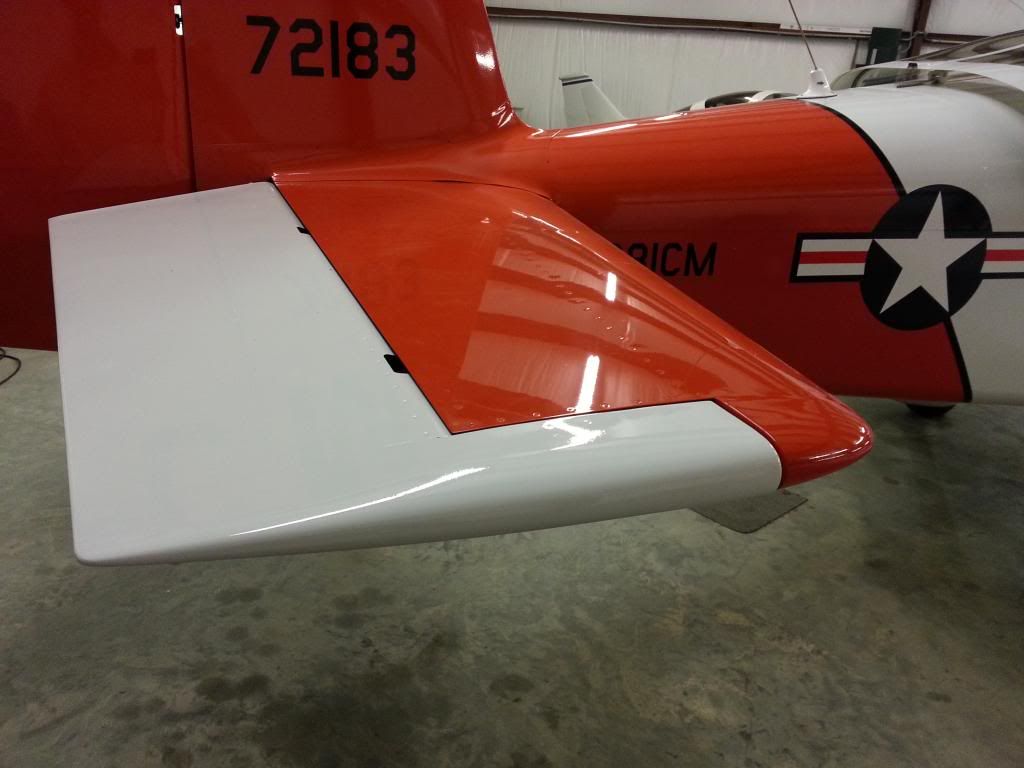

I got the elevator repair completed and flew this afternoon!
It felt great to get back in the air!!
I just repainted the tip area. I had to replace the fiberglass tip and do all the glass work.
I touched up all the rivets that are in the skin to spar with a small artist brush and you really can't tell it's been apart!

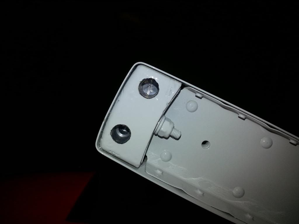

I few quick data points.
My elevators were balanced "together". They were still "perfect" after the spar replacement.
I decided to balance them separately and fly another 900 hours to see if it helps

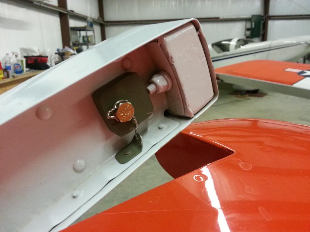

I had to add 2.4 ounces to the left elevator at the tooling hole. Not sure how much I drilled out of the right counterweight. I had installed a nutplate in the tooling hole during the build so I used it on the left elevator. I also safety wired this bolt just to be sure it doesn't back out.
Mark,
Congrats on getting your plane back in the air.
However....that little tab and associated stuff you have added just doesn't give me a warm and fuzzy feeling. If any of that ever managed to get loose it most likely would jam the elevator...and ruin your day. I think this is a case where the cure is worse than the disease.
I would remove the extra weight so I would never have to worry about it coming loose....this arrangement raises red flags for me.

Mark,
Your fix looks great. Your down time was minimal. Not sure what Sam doesn't like here, it all looks secure to me. Safety is correct and my guess is the bolt securing the weight is either in a nut plate or self locking nut. How much more secure can you be?
