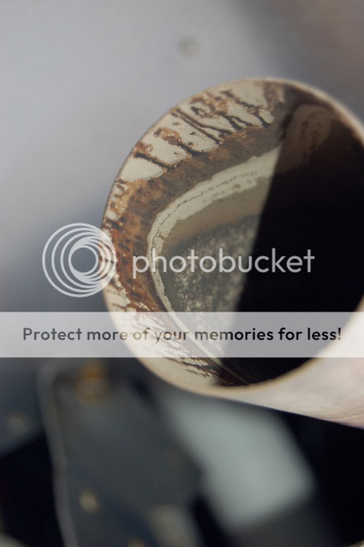

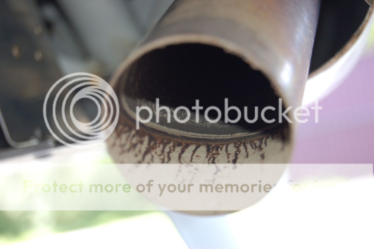

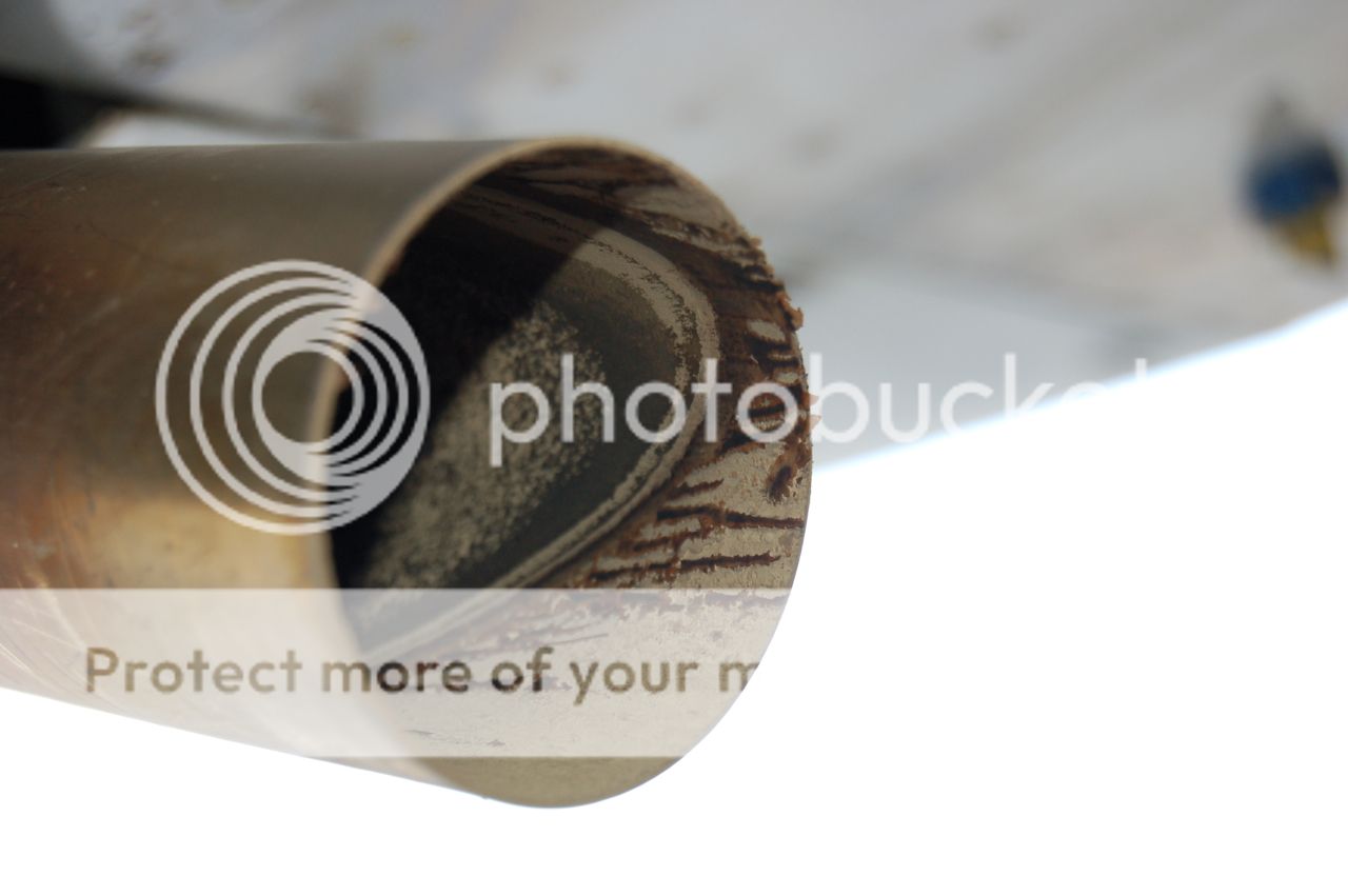

Bob can you read these deposits? On recent loooong trip I burned all kinds of fuel. Mostly avgas, then some mogas, one load of ethanol laced 87, then avgas again. What are those brownish streaks?
Possibly lead bromide deposits from the combustion byproducts of 100LL?

Just a wild maybe but iron sulfate? A solid material resulting from sulfur in fuel combined with condensed exhaust water forming sulfuric acid that dissolves minute amounts of Fe in the exhaust pipe then, evaporates as the pipes warm and leave the streaks. The change in color where the streaks begin seem to be the hot zone of the exhaust and the border is where the air blast from ahead has cooled that part of the pipe, the tip.
If this is correct then warm water will completely dissolve it.
There used to be much more sulfur in fuels than today. I have seen something similar in diesel exhaust pipes using high sulfur fuels across an oxidation catalyst in below zero air.
Or- it could be something else entirely and this is all my vivid imagination.
