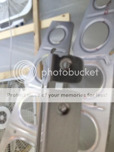

As you can see from the picture, I nicked the tab on the outer most rib when trimming off the tab. Should I buy another rib, make a doubler, or not worry about it? This is for an RV-14, so I am not sure if all models trim off the end rib flange of the outer most rib.

If its just one, I'd use it and move on. Just make sure it isn't a sharp corner that will tend to crack. Keep on building.

I already smoothed it out. Thanks Ken
