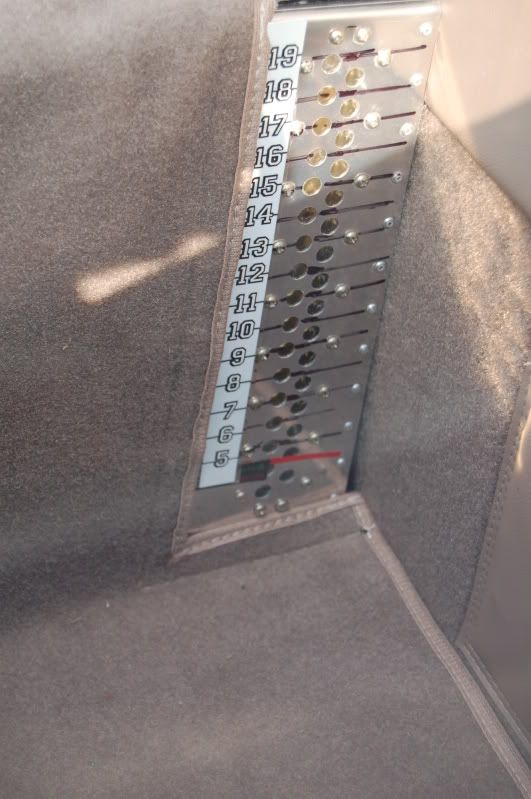

Originally Posted by NASA515 View Post
I like the Moeller gage, and consider it a useful aid during the fueling process ---- BUT, ---- not enough to drain the tank, remove it, open it up, and go through the cutting, drilling, sealing, pressure testing, reinstallation process.
After running an estimated 325 gallons of fuel through N737G, I just don't think it's any big deal. If my wife is around, she gives me a heads-up on the quantity. When I'm by myself - like yesterday - I've got the whole process pretty much down pat, and can run it right up to almost full without any problem, and then squeeze in the little extra to top it off (which the auto gas stations tell you not to do) by just listening at the filler port. I've got the gurgle sound figured out too.
I'm dubious as to the value of checking in-flight. If you have a quantity problem, and it's not going through the engine, then there must be a big leak somewhere. With the tank right behind you, and the lines right under you, I'm a thinking there would be something to tip you off if that was the case.
I DO lament the loss of the sight glass holes however. I have no problem seeing the fuel level - if you do, just shake the airplane a little and you can see the level bounce around.
I agree with Scott, however (you see Scott - we DO agree sometimes....), I firmly believe in visually confirming the fuel level on any airplane - be it a Cessna 172, or a Cherokee, or the thousands of Boeings I've fueled over many years. There have been more than enough fuel exhaustion accidents due to gauging errors, to have made me a believer, and tolerate the doggone fuel running down my arm from a dripstick. Yuk!
Without the sight glass holes, you're totally dependent on two invisible systems - a mechanical gage and a computerized one, both vulnerable to errors - a much less robust system. I like to SEE the gas. Like the movie line "Show me the money" - for me, it's "Show me the gas."
Bob Bogash
N737G
I've reached the same conclusion. I'm going to pass on the Moeller gage mod. Just calibrate the sight gage every two gallons with a sharpie. Before fueling read the fuel level and calculate the gallons to add. About .5 gallons before reaching the calculated top off quantity to add, slow the refill rate until reaching top-off. I also like having the sight gage as a built-in dip stick.

Default Simple sight gauge calibration
If you search on sight gauge you'll find my post from a couple of years ago (09-11-2011) with the info on this simple sight gauge readout. It's easy to check the fuel level and cross-check that against the Dynon before ever climbing into the bird. As note above, gently rocking the airplane makes it easy to see where the fuel level is.
If your sight gauge isn't leaking (mine's been good for 200 hours) why would you go to all the work to install a more complex system that increases the probability of failure?
