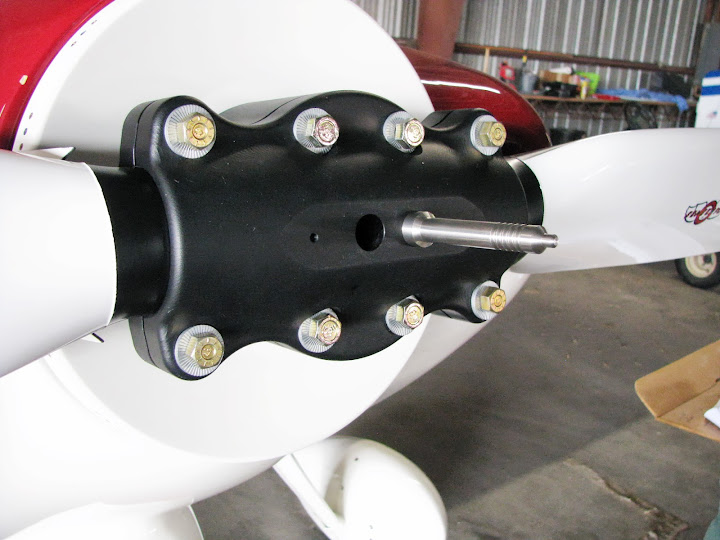

It takes about the same amount of time to take the spinner off and re-install it as it does to loosen the prop bolts, set the pitch using the machined stainless steel pitch pins , and re-torque the bolts. Once you've got the procedure down, it's probably about a 15-20 minute task. All you need is a good Philips screwdriver and a 3/8 drive torque wrench with a good quality 5/8" six-point socket to set the 45 ft-lbs torque on the bolts. I spent a lot of time meticulously bringing the torque up starting at 20 ft-lbs and increasing 5 ft-lbs at a time until I hit 45 ft-lbs (540 inch-lbs) for the 7/16" bolts. It's probably a good idea to check the blades' runout after torquing down... I set a portable carpenter's workbench next to the blade, put a mark on the bench with a Sharpie marker on the bench where the blade tip just barely touched the bench at about the 5-o'clock position then carefully rotated the prop around to check the other blade without moving the aircraft, and both blades always lined up perfectly against the mark for me.
I'm still a bit concerned about how many times you can re-use the NordLock lockwashers. They feel like a really positive lock when brand new, but once you remove them for the first time, they make a really loud clicking sound, but seemed to torque back up just fine... but there's definitely some amount of wear happening to their ridges when you do that.
I'll probably buy a supply of spares to keep on hand for the future just because the comfort factor of using fresh lockwashers is going to be worth the cost for my peace of mind.

The Nordlocks used (size = NL12SP, part# = 1531) are about $2 each when purchased individually, or you can get a package of 8 for $15 from Zoro Tools. The inner diameter hole of these Nordlocks is actually the size for a metric M12 bolt, which makes it a little large for a 7/16" prop bolt, but they they needed a washer with 1.0" outside diameter and Nordlock does not make one with the large outer diameter and an inner hole for 7/16 bolts.
With the awful noise they make when you loosen them, it's gotta be wearing down the inside locking cam ramps pretty good, so I'd hesitate to reuse them more than once... for a grand total of 2 uses, and the advice to not use them at all on "high grade" bolts (e.g.. prop bolts) is probably a good idea.
I've re-used mine exactly once, since I only had the set that came with the prop, but will definitely buy a supply of them to keep on hand for the next time I wish to change the pitch.
There are also two small Nordlocks used for the two #10 screws that hold the front spinner bulkhead to the prop hub, but since those slip on the carbon fiber bulkhead instead of the cam ramps when you loosen them, they can probably be re-used infinitely. Next time I remove those, I'm probably going to get a couple of #10 screws with drilled heads and safety wire them together instead of relying solely on those two Nordlocks.

Installing spacer, rear spinner bulkhead and back half of hub
Blades inserted and front half of hub added
Setting pitch of blades
Checking blade tracking against a Sharpie mark on a portable workbench. Both blades lined up exactly the same...
Front spinner bulkhead is held in place with only two #10 screws
The finished installation!
