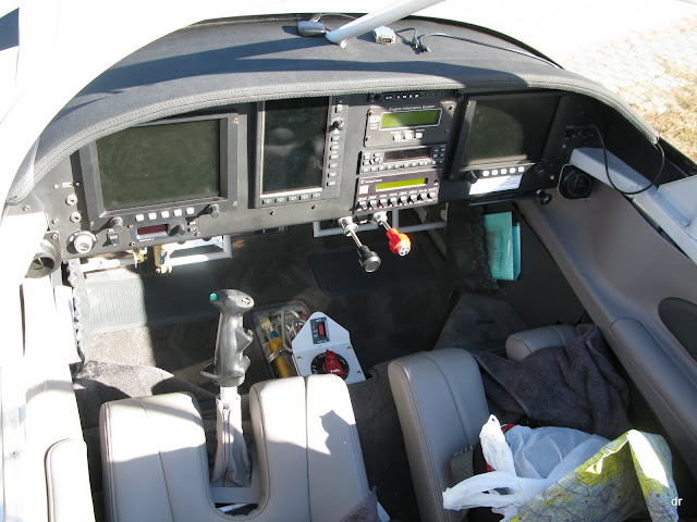

The colour of your panel probably only matters if you're planning on taking pictures from inside the cockpit. Apart from that, you'll probably never notice the reflections when you're flying. I don't, my panel is light beige. But the reflection really shows up in cockpit photos. When I re-do the panel, I'm going matte black, but only because my wife and I like taking pictures.

I've been flying an off-white under PPG matte clear in an RV-8 with no issues at all. Love it.

Mine is light gray rattle can from home depot. I'm still very happy with it and have never, in 1200+hrs, thought that I should have done something different. You could probably reliably guess what color the one in the -8 is going to be if you saw pictures of the current interior.
