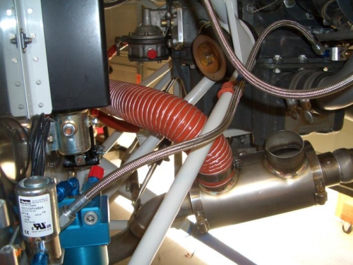

Thanks for the info. I did pull down the spec from everyspec.com earlier and that prompted my question. I could not find an AN part that has the AN800-2 "cup" style end on two sides of the Tee with the AN 37 deg compression "flare" style in the center.
I'm going to use a size -3D flexible Teflon S.S. braided hose to connect the VAN's Primer Parker Solenoid valve on the firewall to the back side of the engine. I didn't want to use the Van's 1/8 inch copper line between my Firewall and engine. Too much motion at engine start/stop and over time...over time it's going to crack.
Here's my plan...if anyone has a better idea...please share.
1) Swap out the AN795-2 (engine primer Tee) on the aft side of the engine with a Brass Female x Female x Female Tee. (see McMaster.com Part number 5799T21).
2) Install one AN780-2 primer fitting on each female side of the brass tee to accept the SS primer lines on the engine.
3) Attach my flexible SS. braided hose to the center female side of brass tee using an AN816-3D and at the primer solenoid side.
I'm going to get the hose from www.aircraftspecialty.com. I did look at TSFlightlines.com as well...but their web site has no contact number and their Facebook site phone number says it's been disconnected.
Howard

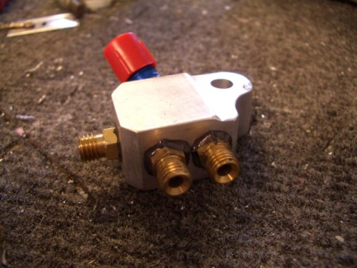

I needed a similar fitting, but also couldn't find what I wanted so I just made one. Mine isn't quite a Tee, but you get the point:
I have some other useful information posted here. May or may not apply to your installation, but at least a local source for the copper tube.

I ended up calling TSflightlines.com for the hose I needed to replace the copper fuel primer line with a S.S. braided hose. Tom was super easy to work with and had the hose made up and shipped out 2 hrs after my phone call. Now that is SWEET Service!
Any one needing a hose should call Tom first. He'll set you up!
